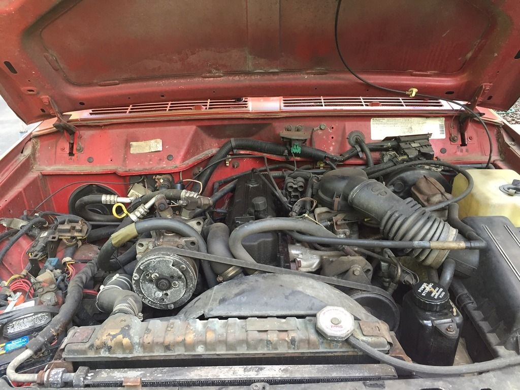

How can you tell if a system is R12 or R134, I don't know much about AC systems and I know that my compressor clutch is leaking out the front, PO said he was placing R
How do you confirm if a system is an R12 or R134? I don't know anything about A systems at all, my compressor is leaking from the front, compressor still kicks on, but I figured it wasn't worth the time to just replace the clutch and bearings, when I can purchase a new compressor and clutch for a little cash. Here is a pic of my system. PO stated he was putting in R12 but that doesn't mean he was correct. Can anyone tell me which system I have, also if the system hasn't been charged and is not blowing cold air I the a reason to vav the lines, can I just change out the compressor and recharge the system?
See less See more
Actually in our Jeeps 134a works just fine. I've converted 3 of them already. 39.8* out the vents, sitting still, on a 90* day is not something you could upstage with R12.
The fittings are different and there should be a sticker in the engine compartment.
