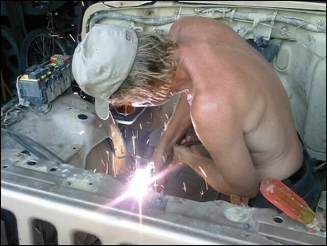

finally stole the ex GFs phone and uploaded the pics here you go, sorry they quality isn't that good its from a camera phone

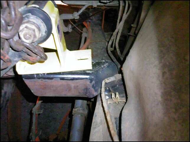

cut old mounts off, gotta love plasma cutters!!
all gone

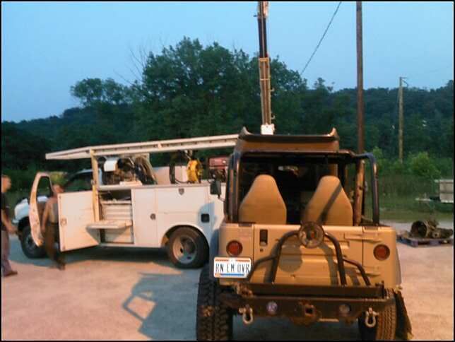

well remember my engine hoist? well it wouldn't work due to bumper sticking out so far, so instead of taking bumper off, we pulled out dads F550 work truck with hoist

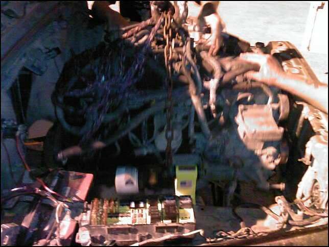

getting motor in place

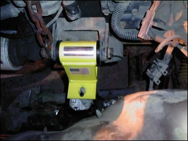

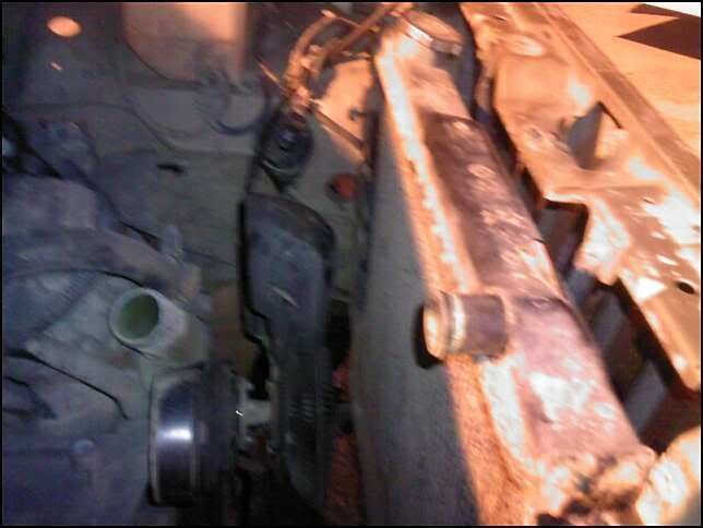

checking for clearance
we then marked mounts, pulled motor, tacked mounts and tested motor again, mounts were to far back,
so moved them up little bit and tried again
Have Cummins, Will tow.
Joined
12,019 Posts
Discussion Starter · #22 ·

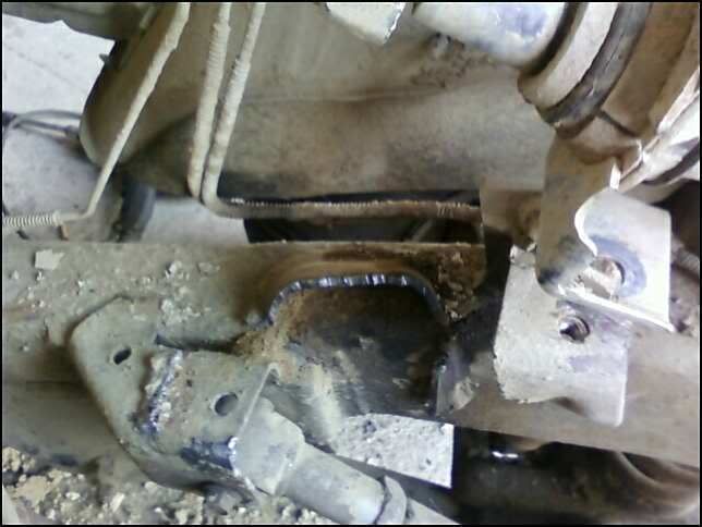

they fit so dad fully burnt them in
his welds are getting better, i dont think these are going anywhere, but just to be on safe side be are making braces this week,
that is all for now, once we make the supports i will bring the jeep home and things will fly then, also if anyone has a truck and would be kind enough to tow my jeep home that would help alot, i will give you money plus gas, i have trailer
