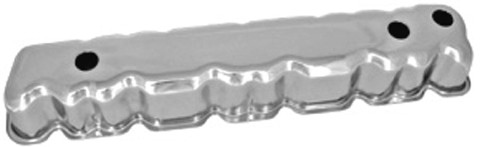

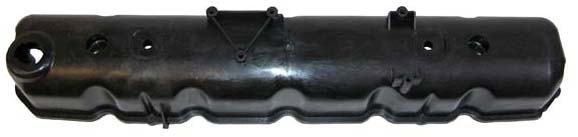

      The shape is slightly different - note the curves along the side.
      Here is what you need (shape-wise)
      This is what you are looking at
      That being said, I found this 1964-88 AMC/Jeep 199-232-258 Straight/Inline 6 Cylinder Steel Valve Cover - Chrome
      Product Description:
      AMC/Jeep 6 cylinder chrome steel valve cover fits 1964-1988 AMC and Jeep 199-232-258 straight/inline 6 cylinder engines. Short OEM style and baffled. Will not work as replacement for plastic model valve cover. Height: 3-1/2".
      Will not work as replacement for plastic model valve cover. Huh?
      I've never really paid attention to the difference. Maybe the way they attach/mount to the head?
      Sometimes something that "fits" will also need a hole drilled or a tab removed.

      on my 83 cj7 i have the 258ci inline six (stock with plastic valve cover) and i cant get the valve cover to seal, i know i can buy a steel or aluminum one for it, and i know i may or will have to drill and tap holes... bummer, but i found a really cheap one on amazon (here is the link Amazon.com: 1964-88 AMC/Jeep 199-232-258 Straight/Inline 6 Cylinder Steel Valve Cover - Chrome: Automotive ) but i have never heard of "c.f.r. preformance". so all i really would like to know is; is this company any good? also is there any better idea for me?

      I have the 258 I6 in my cj and want to get rid of the leaking plastic valve cover. i have searched around but havent really gotten a straight answer from people. so my question is can i get a valve cover for any I6 258 and just drill and tap the 2 extra bolt holes i will need or what. could i buy this one http://www.amazon.com/1964-80-199-232-258-Straight-Inline-Cylinder/dp/B003A6U560/ref=sr_1_1?ie=UTF8&qid=1315938286&sr=8-1 and do that or what should i do. keep in mind i am a poor college student and dont want to spend a lot of money:cheers2:

      I had a similar problem. Leaking valve cover. When I pulled it off it looked like the PO had tried to fix the leak by overtightening the valve-cover bolts to the point that it bent and warped the cover, making it leak much worse.

      HP, if I knew or could confirm that the chrome covers would fit perfectly with no drilling/tapping/etc, I'd probably buy one. At this point I'm not too sure, I've searched this and other forums but so far haven't seen such info yet.
      Once I have the orig cover off in a few days, I plan to check the fit carefully. One suggestion by co-worker here was to put an omni directional flashlight under it on a good flat surface, while in a dark room. Should be able to easily see problem areas.
      Examples:
      http://www.ebay.com/itm/Spectre-Per...ke:Jeep|Model:CJ5&hash=item4d1daf4714&vxp=mtr
      Note above reviewer said orig oil cap won't fit.
      http://www.amazon.com/1964-80-199-2...=8-1-fkmr1&keywords=1979+jeep+258+valve+cover

      Clifford used to make one I guess. You'd have to search ebay/CL to find one, and they are a pretty penny. I also thought I heard someone finding a chrome steel cover that would fit, but never saw if it worked out or not. http://www.amazon.com/1964-80-199-232-258-Straight-Inline-Cylinder/dp/B003A6U560
      Something with the head and/or rocker bridges, or ribbed cover design being changed in '81; or not having front and rear holes or something... I have an '83, so I am not entirely sure.
