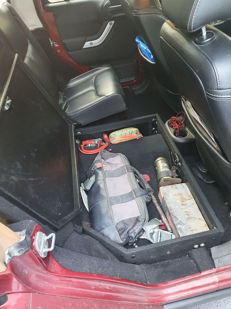

I keep a hydraulic jack and a block of wood in my floor compartment. The jack goes on the block to give it enough height.
"Whether you think you can do something or you think you can't, you are right" - Henry Ford
jscherb is offline
Tell us about that floor compartment. It looks kind of nice.
2014 JKU Copperhead Pearl
Too many mods to list. Too awesome to sell.
Prot is offline
post #11 of 15 Old 08-08-2021, 07:39 PM
jscherb
Location: Elmira, NY
Posts: 12,057
The floor compartment replaces the passenger side of the rear seat.
It uses a prototype hardware kit that includes a bracket the supports the drivers side of the seat once the passenger side is removed, plus corner brackets for the compartment that makes it easy to bolt a compartment together out of fairly simple pieces of plywood.
