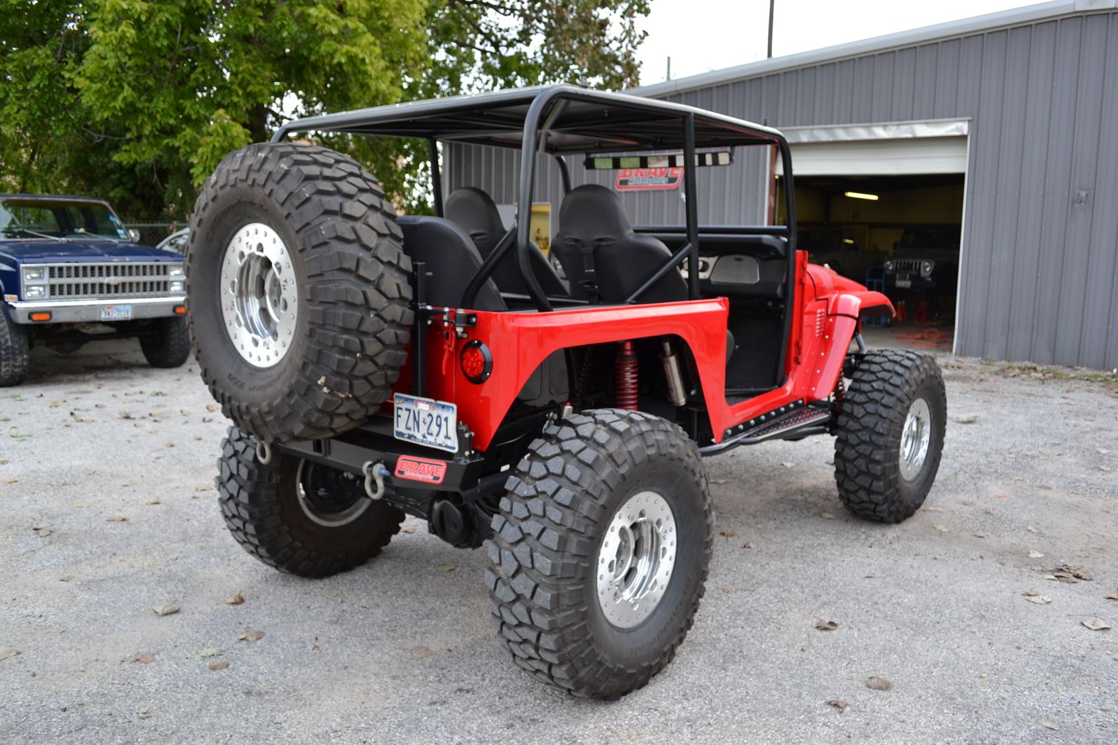

Putting the shock forward of the apex of the tire helps with tire clearance. It also changes the motion ratio a bit so you can pull more travel than the 12" shock shaft. The guys at Brave Motorsports know their stuff!
Here's a similar setup they did on an FJ40 build.

Oh snap! That thing is at Brave? I need to go check it out... looks sexy!
