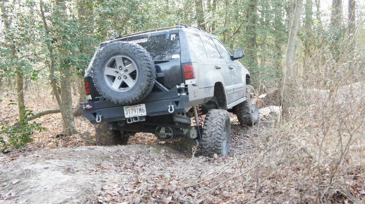

Lol sorry I havent updated my pics. My wk had a 9" lift and 37's on it. It was awesome but couldn't afford to keep it. Sold it ... regretted it and finally bought a jk..
from what I read im seeing stay low and light so im looking at 3.5-4" lift that will flex plenty
Wow, let me see pics of that WK! Seriously. I am in the market to buy a WK.

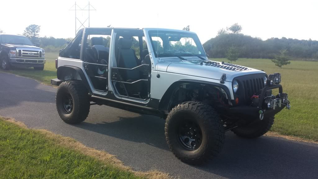

But enough with the wk lol... heres the jk im already planning on adjustable control arms b.c. im aware of the caster problems. I just feel this 2" lift will rub. Correct me if im wrong

If you do the correct bumpstops you will not rub.
