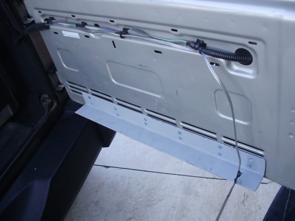

Instead of the "L" brackets, I decided to use a piece of 2" angle iron about 2' long. You can also see the speaker wire I snaked along the pass side in the factory wiring loom:

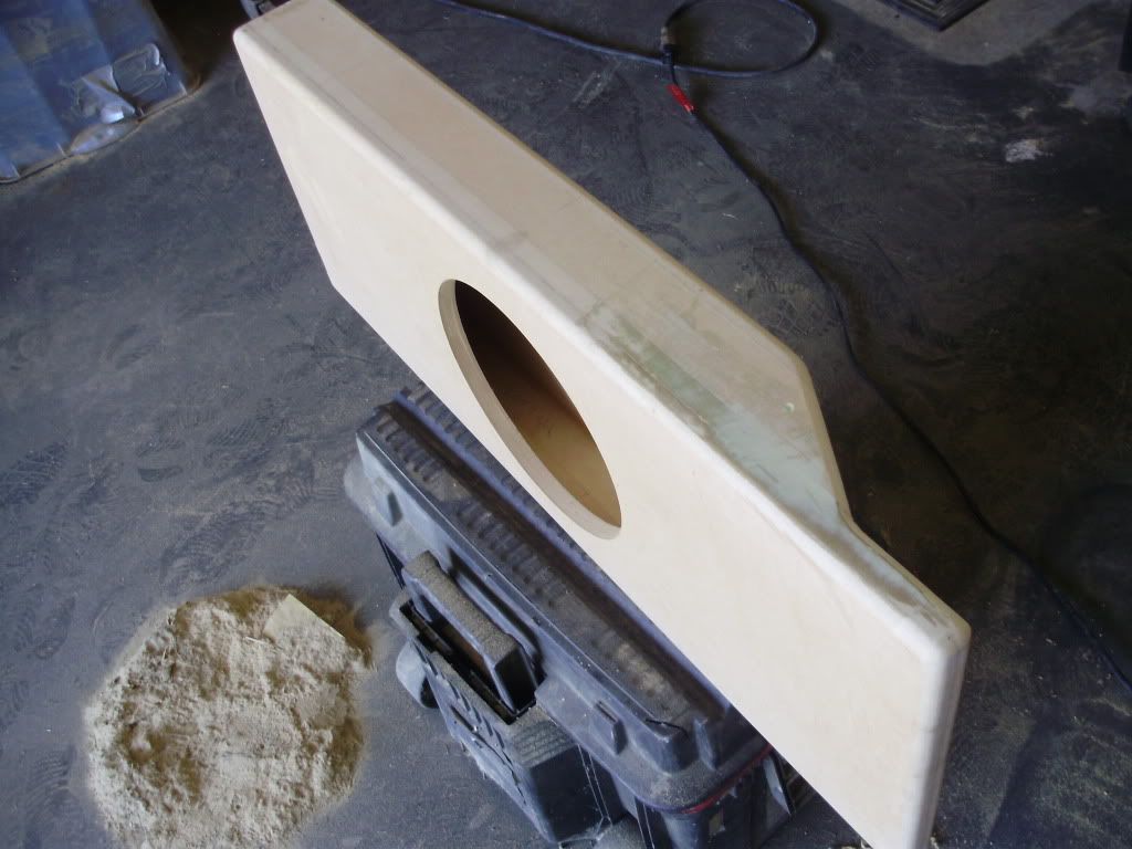

I built a box out of 3/4" MDF. Originally I wanted to mount the sub off to the left and the amp over to the right, but once I calculated the dimensions I realized that the amp would cut into the sub volume, so I just centered it. The box is pretty much a carcass that has been carved out with a router:

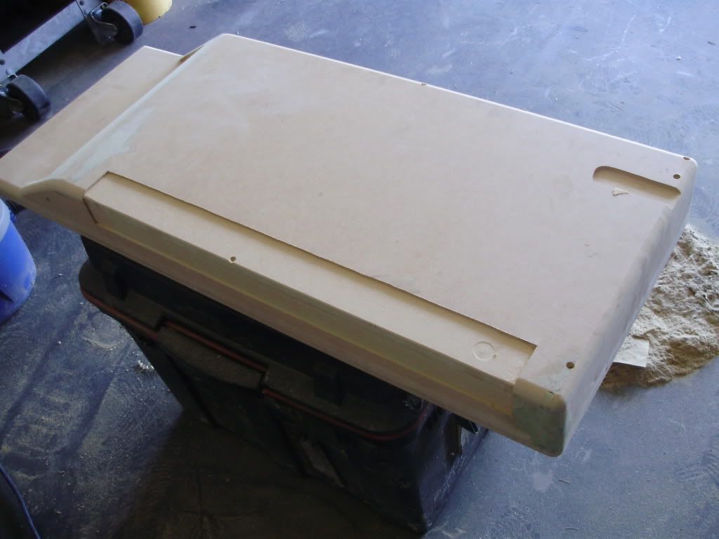

On the back I routed a recess for the wire loom to enter behind the box and also for the angle iron to sit flush:

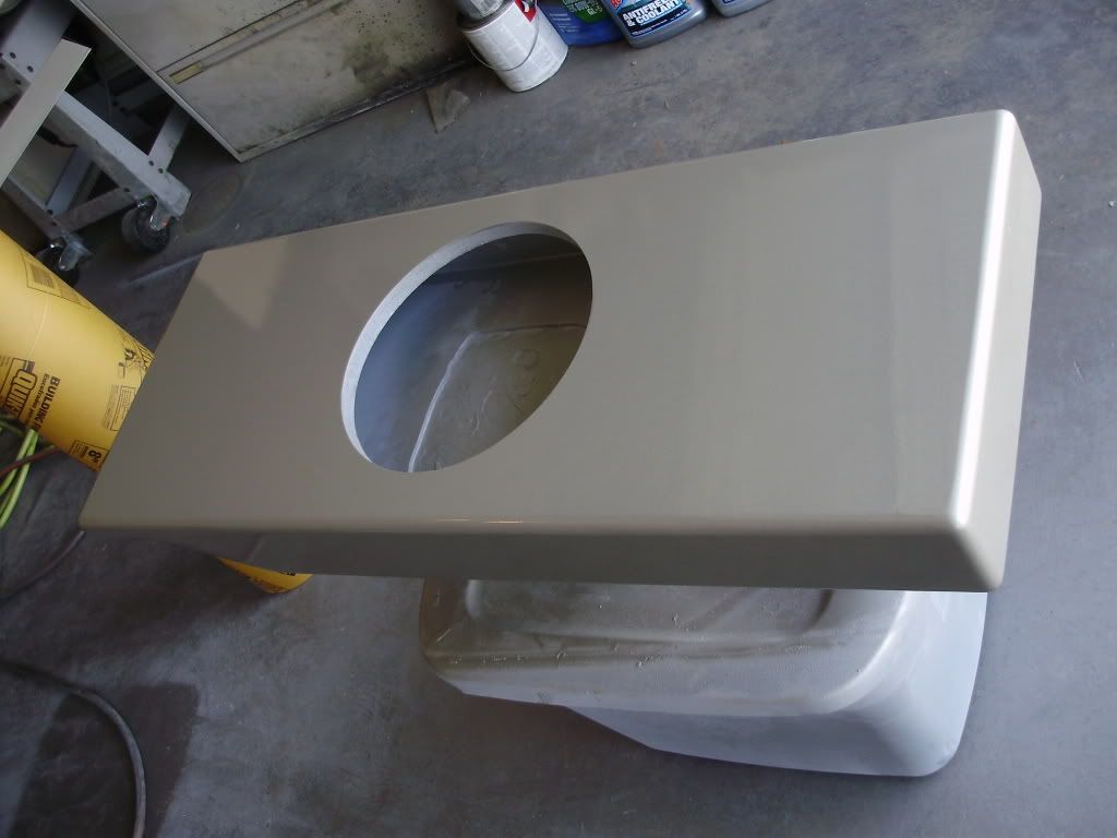

I was a little worried about an MDF box riding around exposed to the elements in the back of the Jeep, so I shot 3 coats of urethane 2k primer and sanded it all smooth, then shot 2 coats of single stage urethane in the Jeep's grey body color. Should be very weather resistant now:

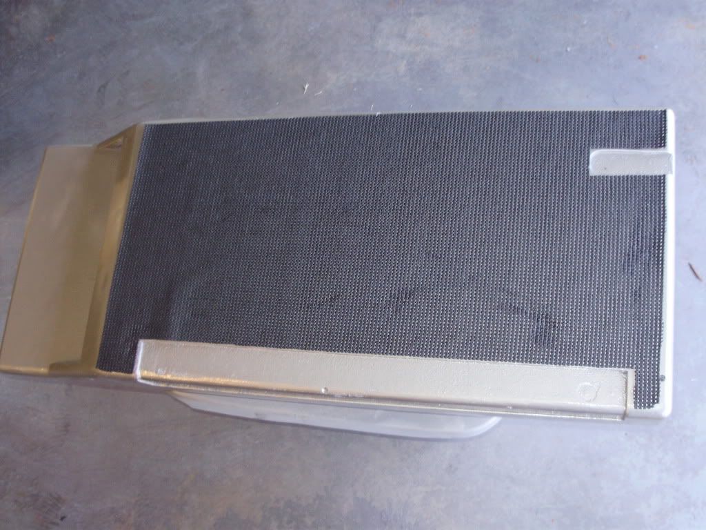

In an attempt to minimize the rattle, I used some leftover foam-rubber drawer liner from my rollaway toolbox to act as a padding between the box and the tailgate. It's glued on with 3M Super 77:

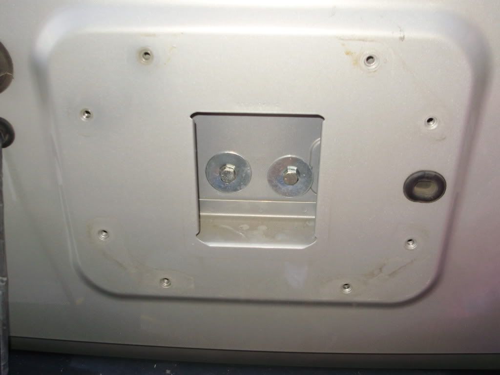

With the box resting on the angle iron, I removed the spare tire, drilled a couple 1/2" holes and through-bolted the box to the tailgate using fender washers on both sides:

FWIW, after 6 months riding around in the back of the Jeep, including a couple offroad trips, it has really stood up to some abuse and has almost zero rattle to it. The L-bracket / angle iron turned out to be a great idea for supporting the weight. In addition, I found that removing the plastic vent piece on the tailgate before mounting but leaving the rubber grommet thingies installed plus through-bolting the box behind the spare tire carrier was critical to killing vibration.
