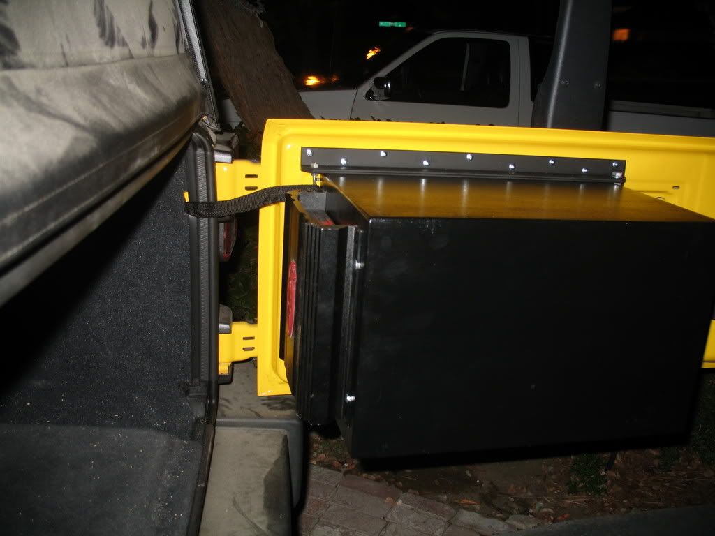

This is my first write up, so I apologize if it sucks. I have been looking for the right subwoofer solution for me for a while. It seems like to get good sound you have to give up your cargo space. Well I refuse to compromise. I wanted to have cargo room, and still have the locking storage usable in the back. My jeep is a 2 door, but it should work on a unlim. too.
OK enough jibba-jabba. I bought a P3L-S12 by Rockford Fosgate at my local Best Buy. It is a loaded slim box with a 12" P3 woofer. This thing rocked loud wide open in the store and is less than 6" thick. I got the idea from a stealth pod to mount it to the tail gate. I am sure that another downfire setup would rock harder but I promise this smokes the factory sub, and the basslink etc. There isn't much to explain, so I will show you what I did. I have less than 50 posts so maybe someone will no clicky the pics. thanks if you do.
I got some L-shape brackets from Lowe's and some body screws and attached them to the gate with foam behind them.
(they are level and straight. the angle is an illusion)
then I bolted the sub to them and attached the side brackets that came with the sub. ( i made some spacers out of plastic to fit better)
thats it. pretty easy. I had a hard time drilling the tail gate but I am so glad I did it looks and sounds great.

This rocks! Nice work. Does the door rattle any or does the foam work pretty well? Can you send some picks of where you have the amp. Do you only plug the sub in when the door is closed I am assuming?

Thanks! I have it plugged in all the time although it isn't plugged in the photos. The cable is run through the factory wire-sleeve/door-catch thing and behind the box. It does vibrate a little at the plastic grill thing to the right of the box. I am getting some dynamat to put in it, and I think it will be ok.
