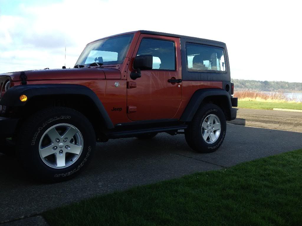

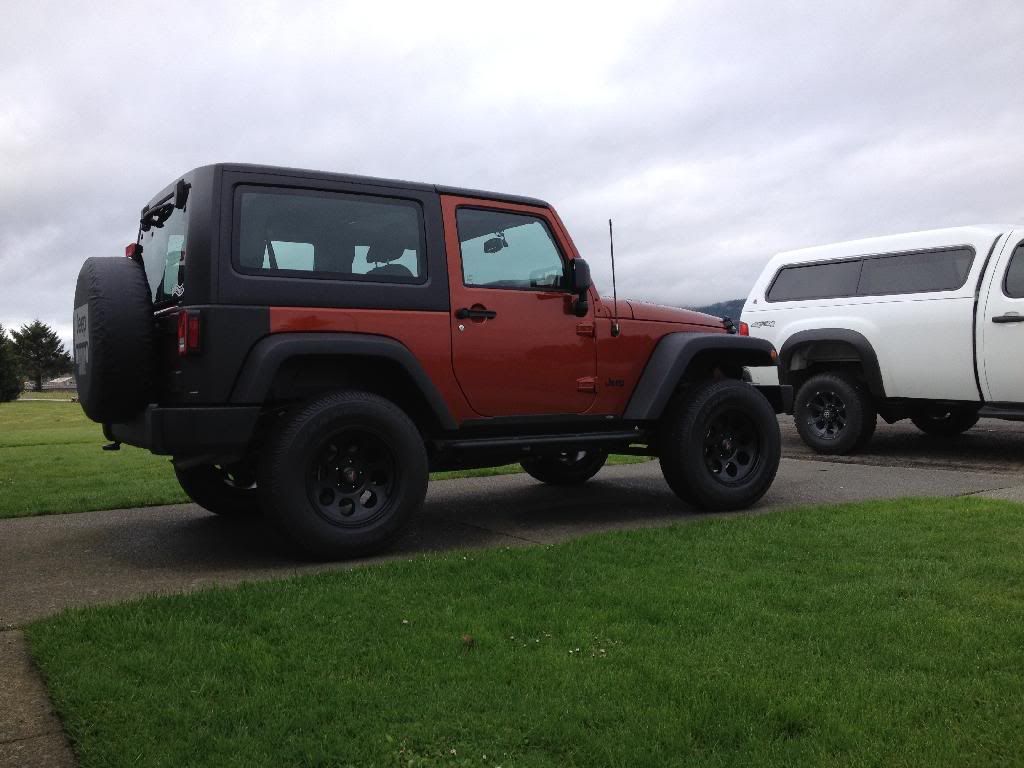

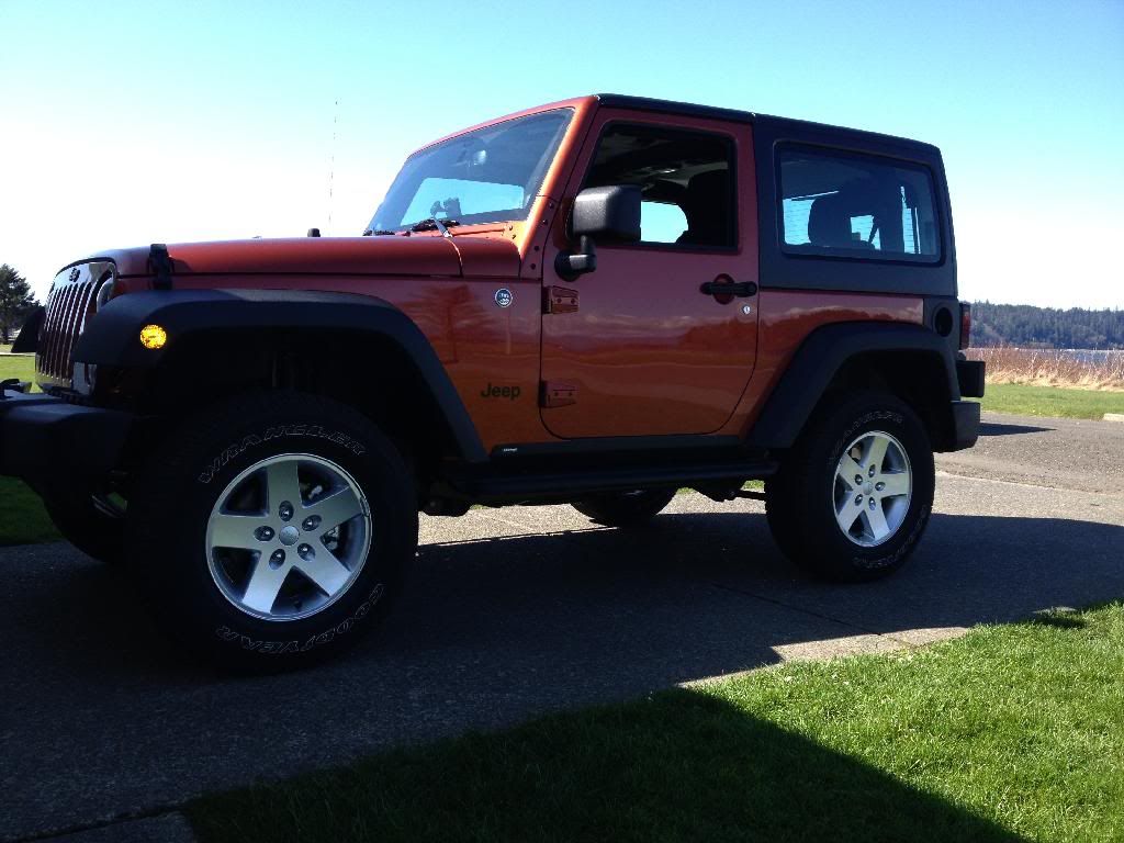

I threw some "Unlimited" springs on mine along with 3/4" pucks all the way around. The Jeep came with 14/56 combo and I went up to 17/58's. I gained 2" up front and 1.5" in the back all tolled (pucks and new springs). So the springs accounted for 1.25" up front and .75" in the rear. Removed what rake I had and it sits pretty level now.
Before:
After:
Maybe a better "after" pic:
