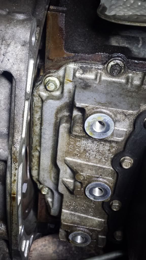

Okay guys I have an oil leak. Lucky me right!
I've got a 2007 Sahara 3.8l. I put dye in the oil to try and track the leak. I pulled the cap off that bolts to the transmission and the block. The lest side is the trans and the flywheel is dry. Right side is oil pan. The oil pan doesn't appear to be leaking but looks like it may be the block? I'm not sure any help would be appreciated. I also wasn't able to.chase the leak up any higher.

When I had oil along the pan/block joint, it was coming from the front of the engine. Before I cleaned all the residue off, I though it may be a rear main seal leak.
Clean all the residue off and continue your leak check. Starting with a clean engine, the source will easier to find.

Thanks for the tip. I'll pick up some more cleaner and go to town. I do t have any instructions for that cover. I think it was I lyrics 6 bolts. It only took a few min to get it on and off
