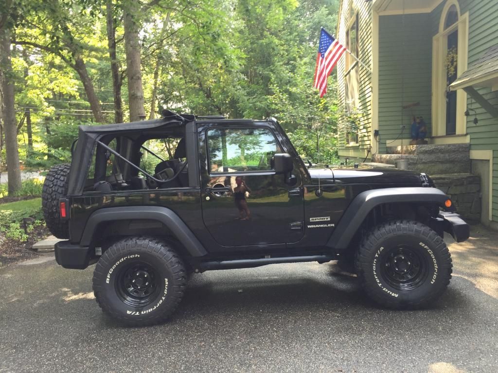

I'm currently running 33x10.5x15 KM2's on 15x8 w/ 3.75 BS and I'm not a fan of the "squatty" stance, my fault for not doing enough research before ordering them.

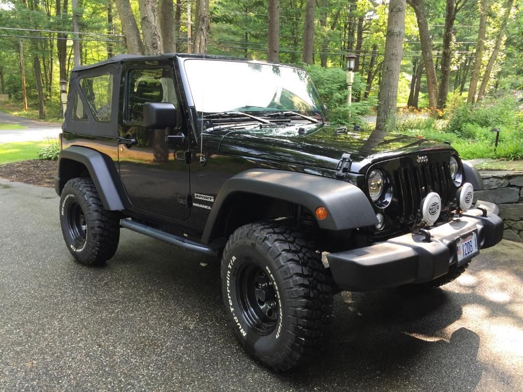

Since your overseas, I assume that your wife took the pictures for you?

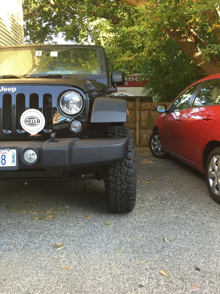

Here's the "Squatty" stance aforementioned that I don't like.
yes, she did. She's been enjoying the Jeep, even relearned how to drive standard so it didn't sit all year. She's a keeper.

Any pictures of how far a 35x12.5x15 tire will stick out of the fenders with 4" backspacing on an 8" rim?
