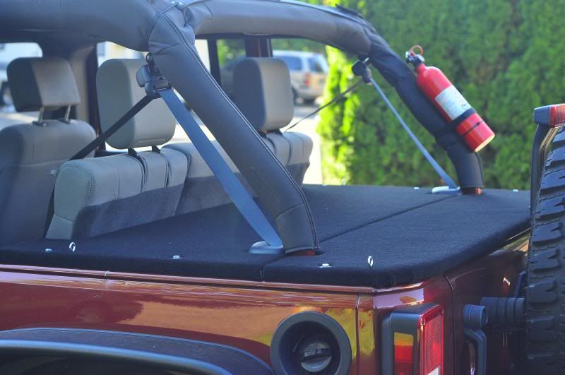

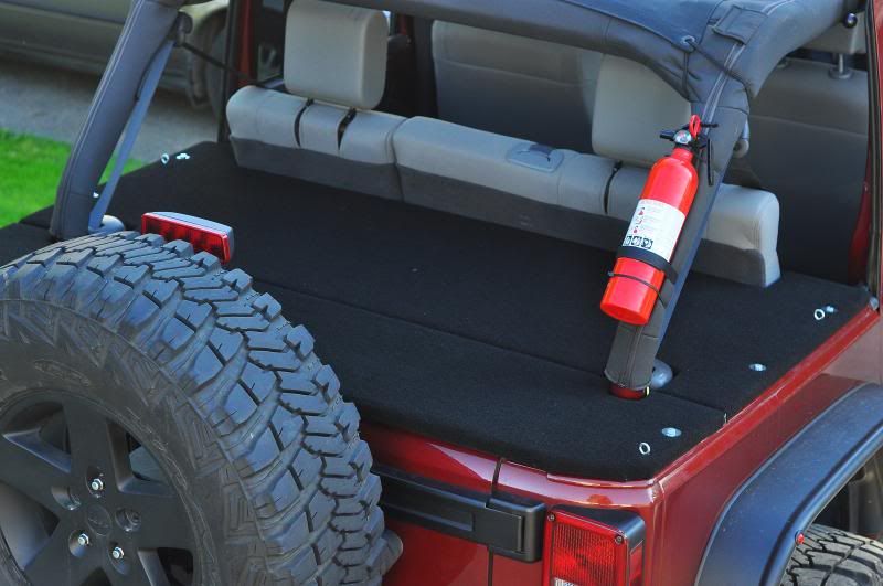

Heres mine I pretty much fully copied from the post above.
It doesnt fold up, and its actually not that big of a deal. If it were to open, it would only be maybe less than 35 degrees it would be able to open up to.
I dont have an answer for the rear seat fold though. As long as your door is locked, they would need to do some major crawling around to get to the back. So if your in a public area, I wouldnt worry, because someone may notice someone trying to get into your car haha

Behind the seat you make a panel that goes from the cover to the floor and you anchor on the child seat loops...
This way the trunk is locked even with no doors...
Also, good job moony john, looks very similart to mine...!

Haha yours was a good model for me, I knew my standard at this point haha
Did you make that rear seat blocker?

I made it but only attach it when needed because i often carry 8 foot lumber by folding the seat...

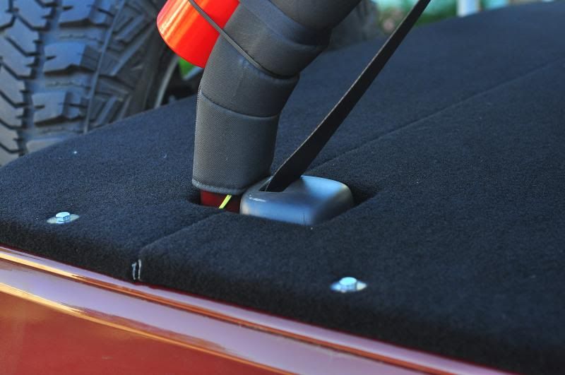

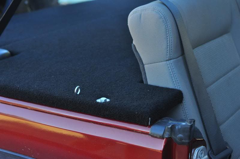

Here's mine - I wanted it under the tub and strong enough to be stood on. 3/4 in plywood - flat blacked it several times and bed coated it a few times to make sure its sealed. Glued on outdoor carpet, and just for good measure scotch guarded it. Cut the main tub piece in half, drilled out the support holes and installed. I have the 12 gauge superstrut I'll be installing underneath for support and to mount other stuff to. Its very solid as it sits now but I wouldn't want to see anyone jump up on it! I still need to install the tiedowns up top but I'm really liking it and can't imagine why I didn't do this years ago! I was going to use a set of cool black torx bolts to bolt the pieces together that would have disappeared in the carpet but naturally they were 1/4in short so I just used some 1/2 in bolts I had!
