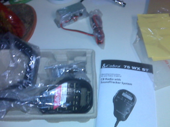

well...finally got this in today. tomorrow morning it goes in. anyone have any advice?
b_c
Take out your glovebox and ziptie the remote unit to the crossmember in there.
Take off your AM/FM covers and install your mounts; grab your power from the cig lighter on the left.
Crimp everything tightly; don't mess with solder unless you're good at it.
Heatshrink the taps, and close up the center console. Carefully locate a nice location to drill the hole for the hand unit to plug into the remote; use the proper size bit to drill the hole or use a unibit slowly. Screw the connector in place, hook it together, tune your antenna, and start jabbering with truckers.
The only ways you can mess it up is if you go red to black for power (cross polarity) or use the radio with a badly tuned antenna too many times. Get as low an swr as you can; the JK typically can achieve a 1.4 or better.
A good antenna, tune, & install is more important than a big radio...
I tuned my antenna with one of these but a $15 Radio Shack SWR meter will work almost as well.

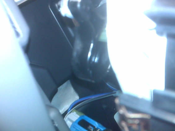

which is positive, which is negative?
blue/purple
and
black/white
these are the wires leading to the left cigarette lighter. i'm guessing black/w is neg and b/p is pos. anyone wanna give me a 2nd opinion?

found it
red goes to blue/pink
black goes to black/white
http://www.quadratec.com/Assets/Installation/103381.pdf

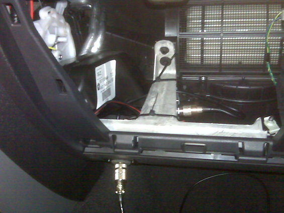

cb install pics
remove glove box (pinch sides to clear tabs) and lower panel (pry parameter)
electric taped box tabs to prevent "rattling," then attached to crossmember
removed lower panel and bolts
removed uppper panel and bolts
separated face enough to get to wires to power outlet on left side (thought it was "dedicated"...)
ran the leads down following factory wiring and spliced into both lines
then i went to go test it, and nothing! i was like f..............!
then i turned the key to "accessories" and low and behold
i thought the one on the left was always live?
drilled and mounted the the gasket and holder for quick disconnect and put everything back together

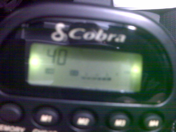

i didn't get pics of the swr meter and the testing, but everything seemed kosher. i may not have known what the hell i was doing though, so i may need to check it again.
i hooked up the meter and had it in "fwd." changed the channel to 1, then pressed transmit. turned "cal" knob to where it was between 1.6 and 2.0, then switched it to "ref." noted that it was at 1.4ish then let go. changed it to 19, didn't have to adjust anything. then changed it to 40 and had to decrease "cal" b/c it was higher than two and switched to "ref". it was at 1.3ish. went back and tested channels 1 and 19 again and i was at like 1.2ish on ref with no adjustments.
is this right? or am i we tall did?
