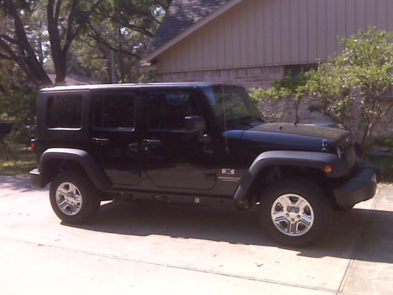

...been out of town training on a new erp system install.
anyway, while i was gone some things i ordered off of ebay and the web came in...(i feel this is just the beginning)
^mine. just about as stock as you can get:
2008 jk unlimited x-s
6spd
manual windows
manual locks
16" wheels w/ street crawlers (p225/75r16)
hardtop
a/c
cd player w/ aux input
d30/d44 w/ 3.21's
so on with the mods, eh?

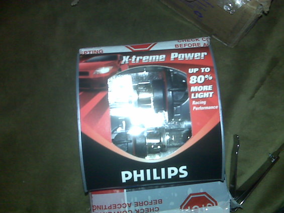

mod 2: PHILIPS X-TREME POWER +80...i have a stigmatism. not a bad one, but it's hard for me to see without squinting to focus. hopefully these will help
suvlightsDOTcom ($51.00 total w/ shipping)
they'll both be installed tomorrow, after i get back from picking up mod 3...here's a hint: it rhymes with moft top

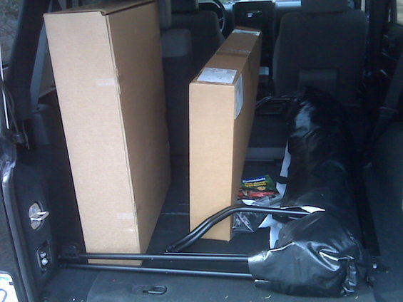

you are looking at a proud owner of a NIB soft top for a 2008 jk unlimited...
...price paid $300 and 3hrs of my time, round trip. thanks tim and nancy
time to eat...install pics of the rear hook and lights after lunch. gonna shelve the soft top until next spring.
...also picked up something from my dad's dealership on the way home
i'll fill ya'll in later.

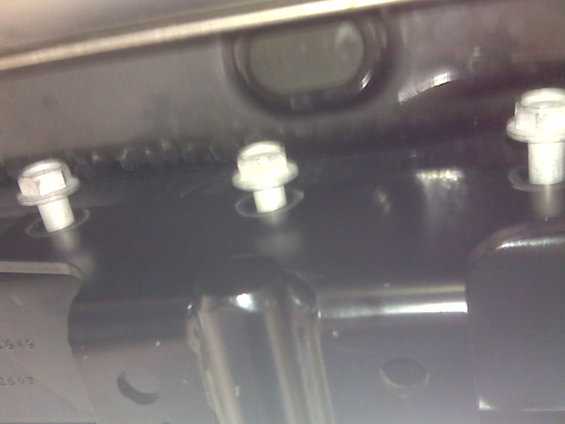

rear tow hook installed :)
installed the rear tow hook
as simple as tightening 3 18mm bolts...i torqued them to 50ft/lbs, just to make me feel good...
