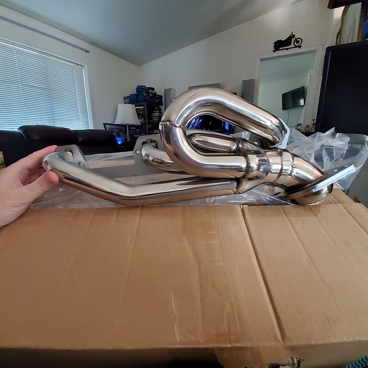

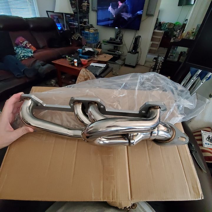

I'd asked about this before and hadn't gotten a response. So I'd found a set of headers for CHEAP on Facebook so I ordered them just to try them out.
I have the Savvy midarm suspension on my TJ so this might be different on others rigs. Since many here have used the stock exhaust manifolds I thought I'd give this a try instead of the block huggers.
So the midarm upper link is right under where these headers dump out at.
But I think I can notch the lip on the tub and snake the exhaust past all of it. I'll know in the next couple of days since the flanges will be here this week. I'm going to be doing 2.5" from the headers into the Y-pipe and then 3" to the back of the rig.
And of course the passenger side is a piece of cake.

Rick, have you looked where your front driveshaft will go? On my rig I had to clear both the link and the driveshaft. Itís tight to say the least, and I still get a small but of contact on my shaft at full stuff - just enough the scuff the paint.
The flanges will be here today or tomorrow so I'll be able to start test fitting some pipe then. I was planning on taking the driveshafts to the shop to get lengthened Friday but might wait until next week so I have time to play with the shafts and exhaust.

It looks like they dump out the same place factory exhaust manifolds do.
If you don’t want to mess with headers, you can get a set of factory 92-93 Dakota manifolds. The outlet is biggest out of all magnum manifolds.

Well this was a huge experiment in the first place and I wouldn't be going thru this much trouble for stock manifolds. I get that for many headers don't seem to help or they cause issues. But I've had good luck with headers and with the way I have this engine built I think headers are going to be needed.
If I can't fit the Y-pipe back there I can always go back to the block hugger headers.
