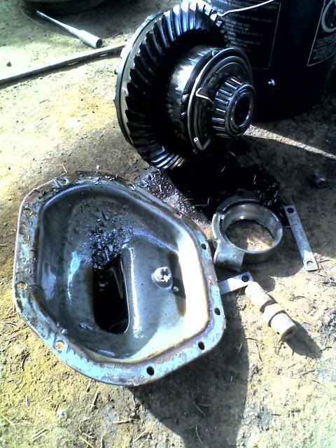

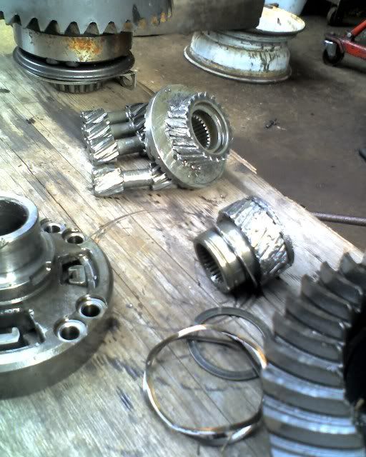

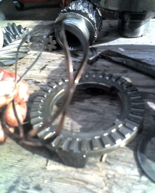

this is the return spring... never seen one stuck locked before.
I had one that poped and snaped for a couple days, then it quit. when it finally busted a year later it looked like this.. I actually put friction modifier in it also..
anyhow, the bores for the planetaries could be worn, which causes binding.
