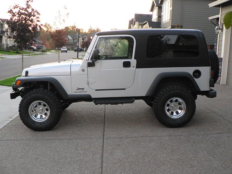

I am boat shopping. I want to buy a Mastercraft X1. It's a 21' wakeboard boat with a relatively narrow beam (90").
The weight breaks down like this:
  • Boat - 3,200 lbs.
  • Trailer - 860 lbs. (trailer has surge brakes)
  • Gas - 275 lbs. (33 gallons x 8.33lbs ea.)
  • Gear - 100 lbs. (aprox.)
  • TOTAL - 4,435 lbs.
Now let's compare the towing variables of my 2004 LJ to a 2002 XJ:
  • Engine - both have 4.0L (tie)
  • Transmission - both have 4-speed automatic (tie)
  • Wheelbase - LJ is 2" longer (advantage LJ)
  • Curb weight - LJ is 366 lbs. heavier (advantage LJ)
  • Limited slip - LJ yes, XJ no (advantage LJ)
  • Brakes - LJ has 4-wheel disc, does the XJ?? (advantage LJ??)
  • Towing capacity - LJ is 3,500 lbs. XJ is 5,000 lbs. WTF???
I would also argue that with my LJ's lift (and lack of heavy bumpers, skids, etc.) the tongue weight of the boat will not sag my rear end much at all. In fact, it may level out my rake
Also, with my siped MT/Rs and 4WD my LJ is less likely to slip on a steep, slippery boat ramp. The stock XJ has street tires and is only 2WD, so slippage is more likely on a slick ramp.
Nobody would worry about towing this boat with an XJ and it's 5,000 towing capacity. Why can't I do it with my LJ which appears to be every bit as capable as the XJ (if not more capable). I wouldn't use either vehicle to tow that boat across state lines, but for day trips (up to 1 hour each way), why not??
Your thoughts please...
