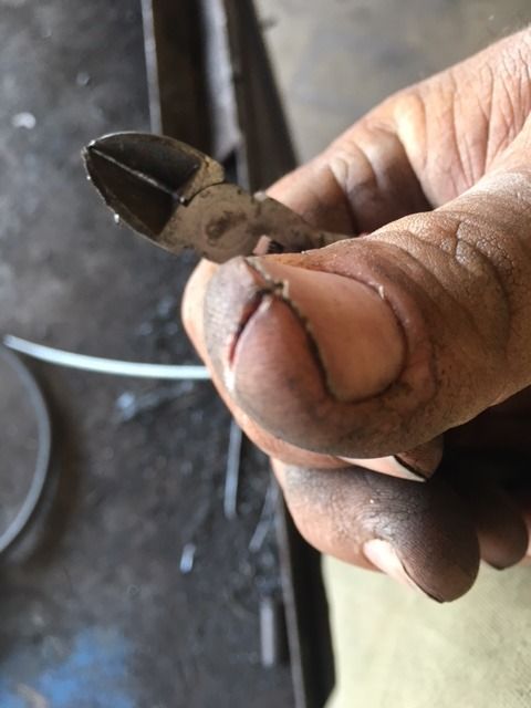

Mine is, the engine died on mine while traveling on the freeway. I was going fast enough that I was able to get over to the right shoulder. The Lord was certainly looking out for me today. Our portion of I-10 is undergoing major renovations and there are a lot of places where there are no shoulders. Called for help, went for the trailer and got to a safe place without major grief.
Turned out, the fuel pump fuse was burned out. Put in a new one but blew that one too. I eventually found that a wire on the fuel pump had grounded. I had installed a fuel tank Rockman steel armor long ago and a wire got scuffed enough on an edge until the bare wire got exposed and grounded. I used some liquid tape to cover the exposed wire and after it dried overnight, installed a piece of split loom tubing and taped the end to hold it in place. That should take care of the problem.
You might want to take a look into that if you have a fuel tank armor installed. I installed a new fuel pump last summer. Would have been a great opportunity to protect the wires but who would have known.
