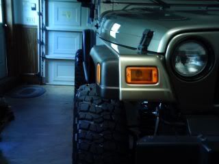

I have the 33 12.5 15 on mine with no rubbing. I do have aftermarket wheels though.
Attachment 189289
Looking good! Do you know the backspacing of your wheels?
I think they are 3.75" B/S.
