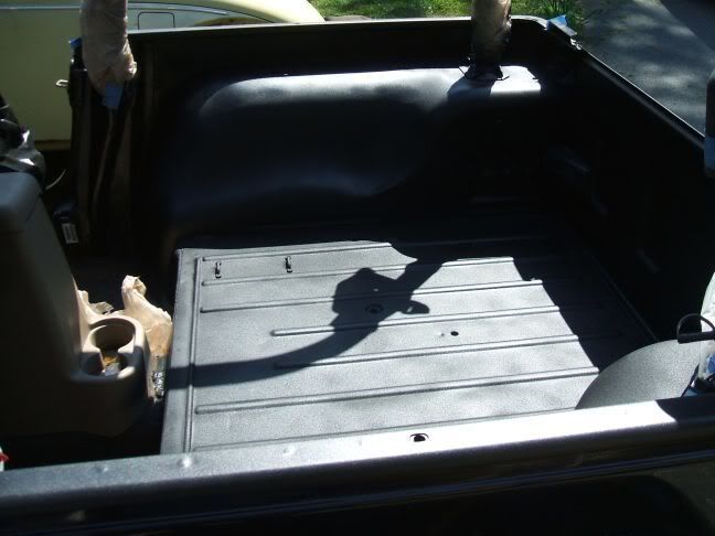

I picked up a quart of the stuff, and a rattle can of it for kicks.
I ended up returning the quart and getting more rattle cans. I only did the rear half so far, the front will require a little more effort. I may get started on that tonight, I've been screwing with this since 7am, and it's 3pm.
I'm tired, and it's hot out.

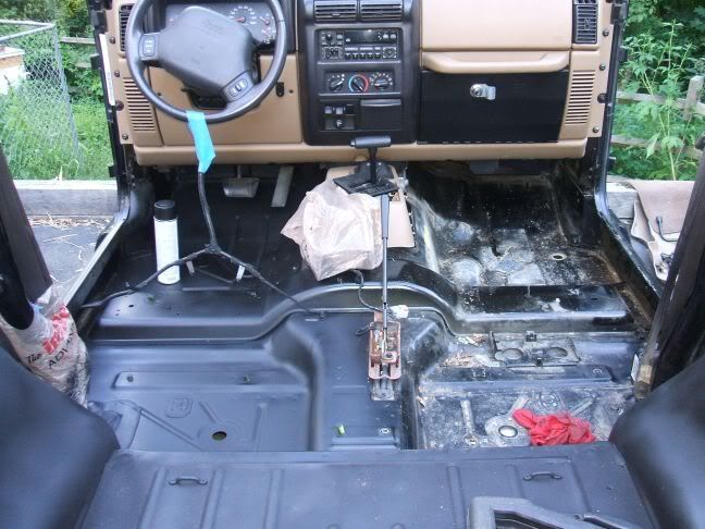

Here's a quickie-shot of the driver side and the beginning rust.
I used 2.5 rattle cans. Plan on using at least the rest of the can on the rear floor to increase the thickness since it's a high wear area.

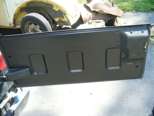

Starting small, I tested the stuff on the inside of my tailgate. It had been bashed a little, this is it after I removed everything off it.
Here it is after a couple coats. Looking a lot better.
And finished, with my dirty parts put back on it. (Gotta wash it now)

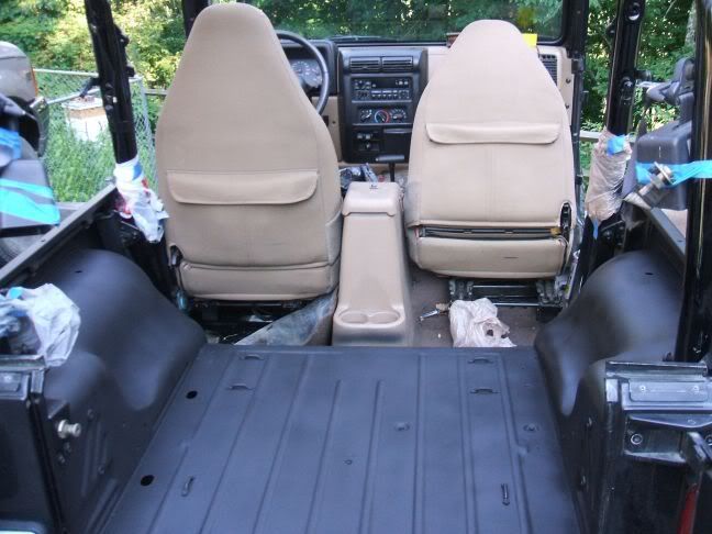

So I went at it with the rest of the rig.
This is what the bed looked like after I lifted the carpet and began taking the seat belts and everything out.

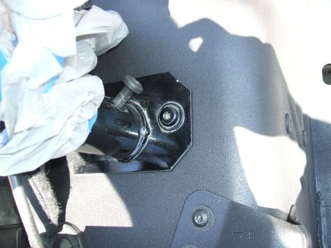

Don't be afraid to use PBBlaster, Acetone or that Mxyol(sp?) will get rid of whatever residue it uses. After this bolt broke, I shot my other rear seat brackets and let them sit a bit while I worked on other things.
Prep is key, sand the living piss out of everything. I used a sanding block to great success, it really sped things up than using just sandpaper.
Acetone...or another de-greaser. Use it.
Tape off, more than I did. I got some over-spray here and there.

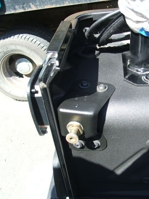

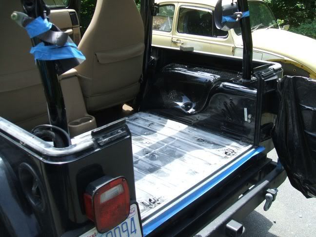

I removed the tailgate bolt assembly, shot the tub, than shot the bolt do-hickey-thingy that attaches to the tub.
While I did do the rails, I didn't do the rollbars and I masked them to keep them clean. (I know, neat shadow huh?)

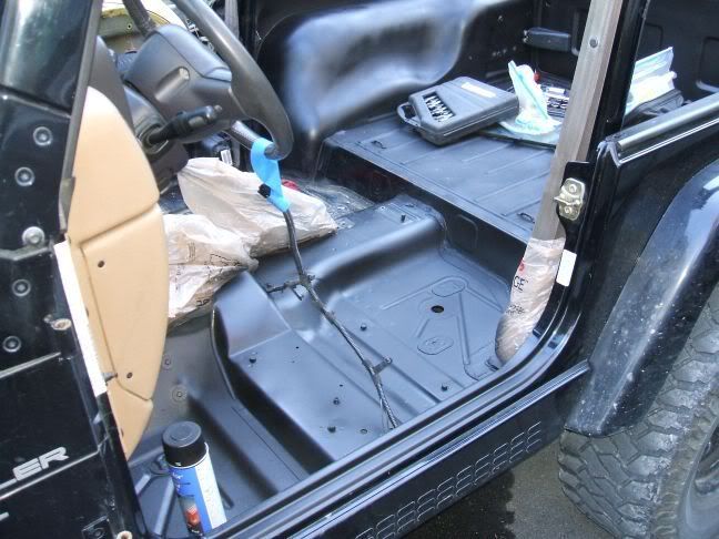

I worked on the rear a touch more, trying to even it out. This is as good as I seem to get it. Maybe after a washing and the loose over-spray particles come out it'll be a more even tone.

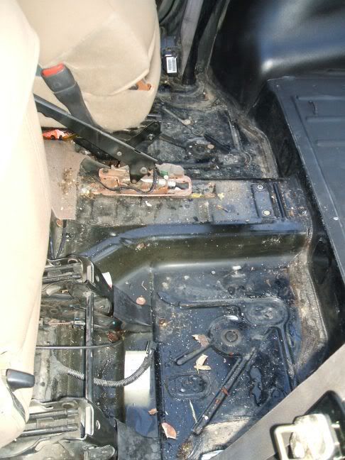

I screwed around some with taking the driver seat out. I can't get the Torx bolt to budge, even after covering it from above and underneath with PB Blaster - it's going to have to soak overnight.
Not to be daunted, I went ahead and start cleaning, sanding, degreasing, and covering to shoot the driver floorboard and the door sill.
I plan on doing the door sill to the dash on the front side, and at the rear all the way to the top of the tub. (Except the bracket where the door latches) I was just really tired and didn't feel like messing with the whole thing right than, I'll do that tomorrow afternoon maybe.
(Obviously not the work of a professional painter.)

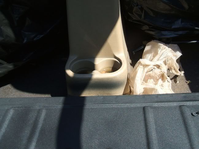

And here's how it basically ended up.
I used an entire can on the driver floorboard and sill, because it'll see the most usage.

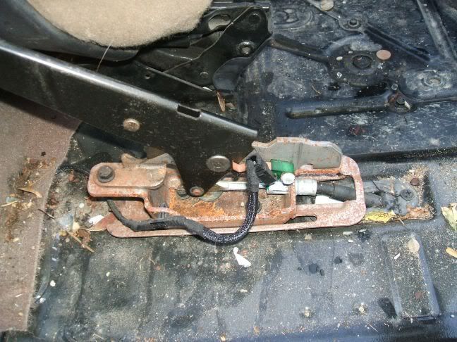

Passenger seat is a mess, the tumble mechanism is crapped out so I can't tumble the seat forward to get the two rear bolts.
Did take off the rear-half of the console and yank the carpet out. It's a mess. I'll try to work on that tomorrow after work.
