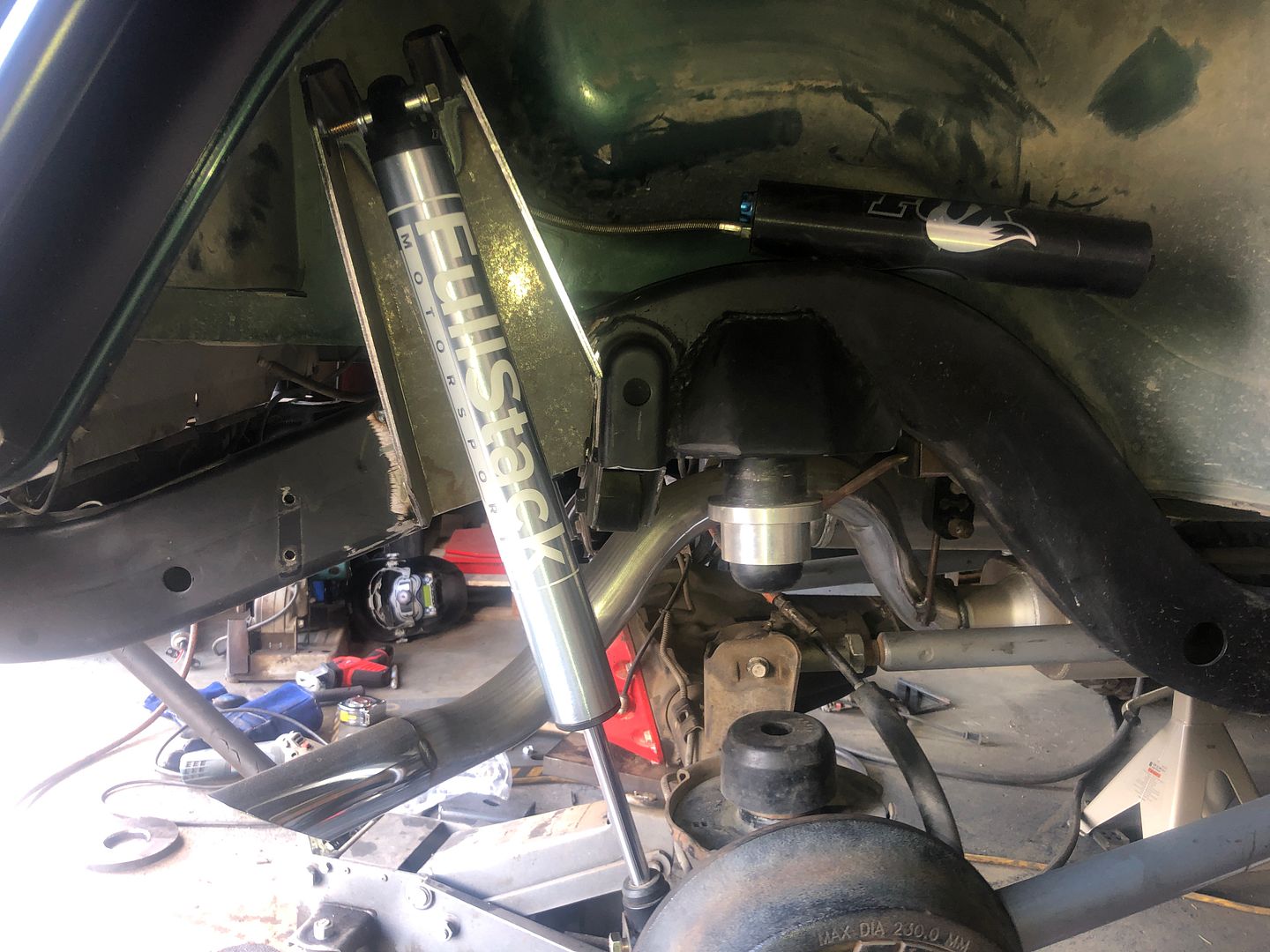

I did mine with poly performance/synergy mounts. It is a big job but worth the effort. You might notice in my thread lots of advice that was mostly after the fact. Some was really good advice that I wish I had taken, some was more opinion. Either way, lots of good details in there. Mine came out fantastic. Worth it in every way. I am running 12" shocks and am much more stable.

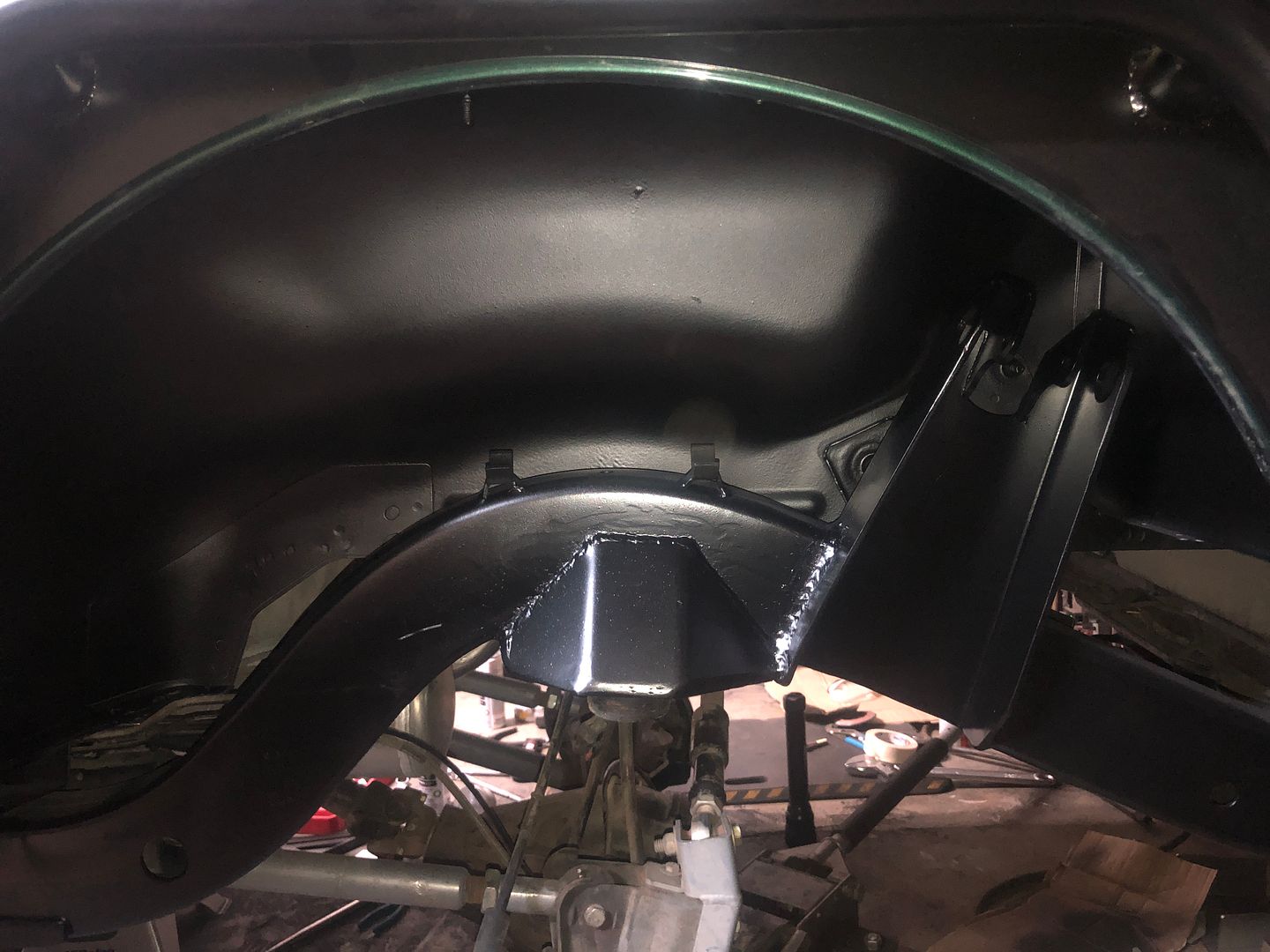

Originally Posted by joe_jeep View Post
notching the coil spring mount with a grinder is the easy way to make room for the shocks
i moved the upper mount up just to get room for a longer shock.
Any pics? I did a upper spring mount relocation, moved the whole thing. Would have been easier to notch for sure
Good point with grinding the coil perch.
I prefer this method because it's free and does not impact available shock travel. Shock relocation brackets will often cut in to available travel.
Not Joe's pics, but here is an example:
https://www.jeepforum.com/forum/f9/r.../#post15407534
