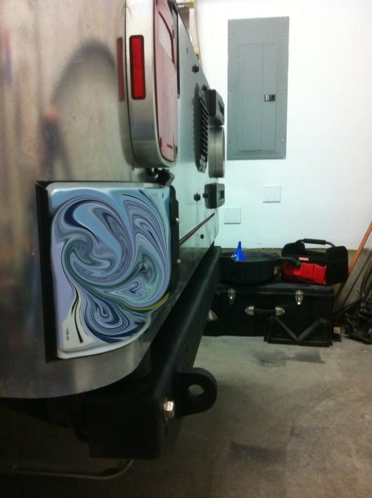

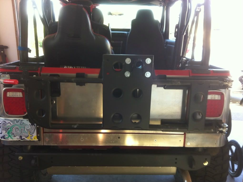

I like my genright crossmember. It's similar to the Rokmen one, but ties into the body mounts to beef them up as well. Genright one is also much cheaper and you can get the tire carrier one with the d-ring for recovery.
Haven't finished painting it though:
