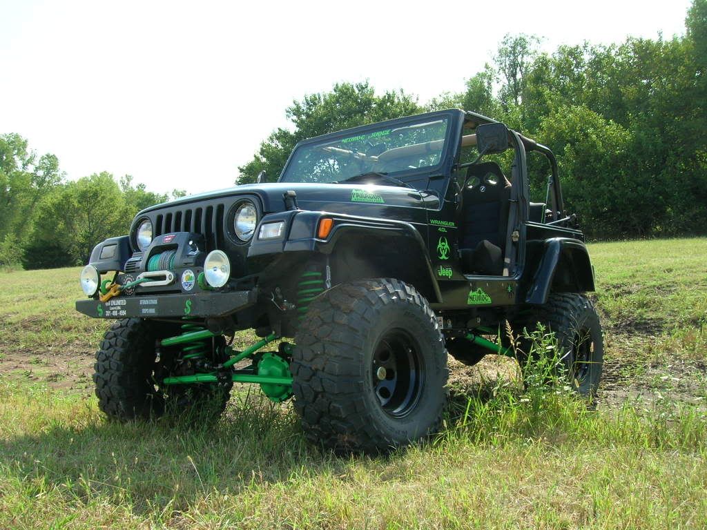

I run the tera flex and it is the bigges piece of **** I have ever been around. The tie rod is bent up like a bow that you would shoot arrows with. Here is a pic just to show you. I have to align it everytime I go wheeling as it keeps bending up more an more. I'm about out of nut to adjust it. I'll be sleaveing it and writing **** YOU ON IT!!!
BUY IT DONT' BUILD IT!! You will be money and time ahead. (Flip off)

Wow... Do you have lots of bumpsteer with your stock track bar configuration? I would imagine that has everything to do with why you don't like it. And how on earth did the tie rod get bent? Drop your Jeep off a cliff and it landed on the tie rod? That thing is huge...
