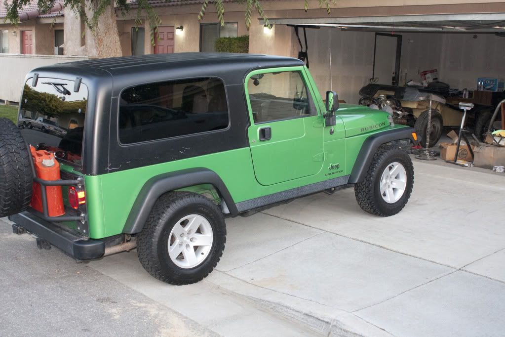

I know there have been plenty of posts already on rejuvenating tired stock fender flares via painting them. But seeing as I've been a member for so long with very few posts I thought I would take this as an opportunity to introduce myself as well as share my experience with this little project.

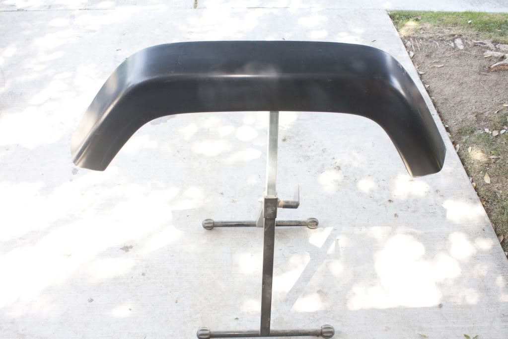

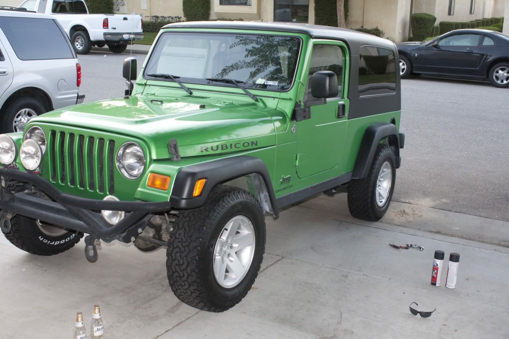

As many of you already know the stock fender flares have a tendency to chalk badly, mine were getting very tired. I tried doing everything from Armorall to Black Magic, and while these products did turn them black again they only lasted days or weeks. Here are some photo's of mine:

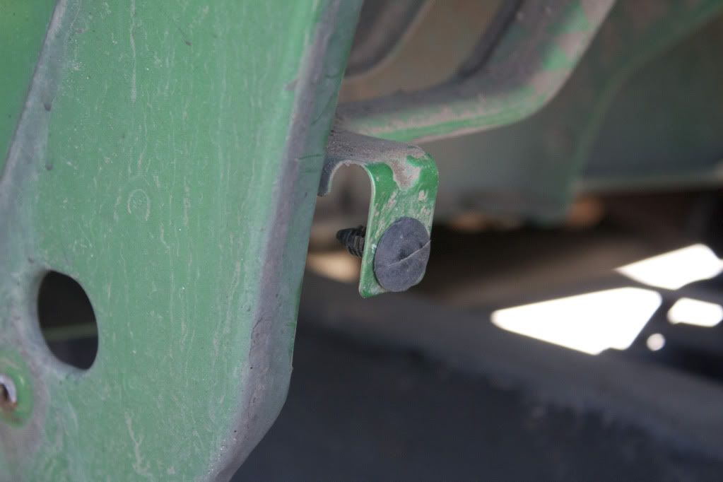

After reading other posts I decided to do this right I was going to need to remove them. There were about 8 bolts for each fender. 3 of each set didn't have a plastic nut on the end and simply unscrewed from the body. The other five however are a real PITA, after blistering my fingertips I dug through the tool box and found some needle nose vice-grips. Clamped them on to the plastic nut and used an 8mm socket on a quarter inch drive, took about 45 minutes before I had all 4 fenders off.

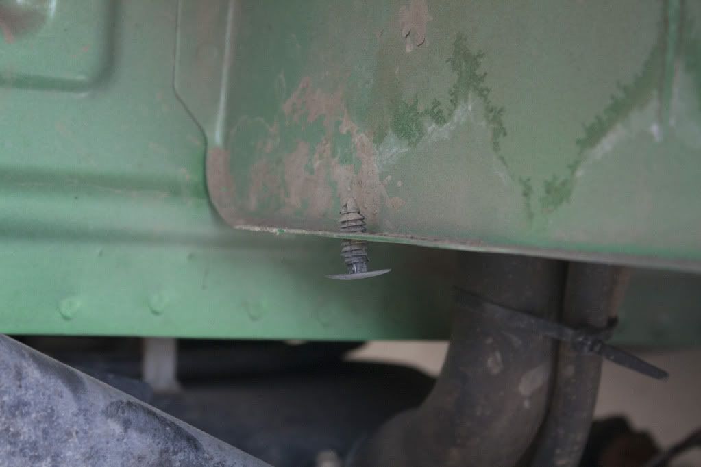

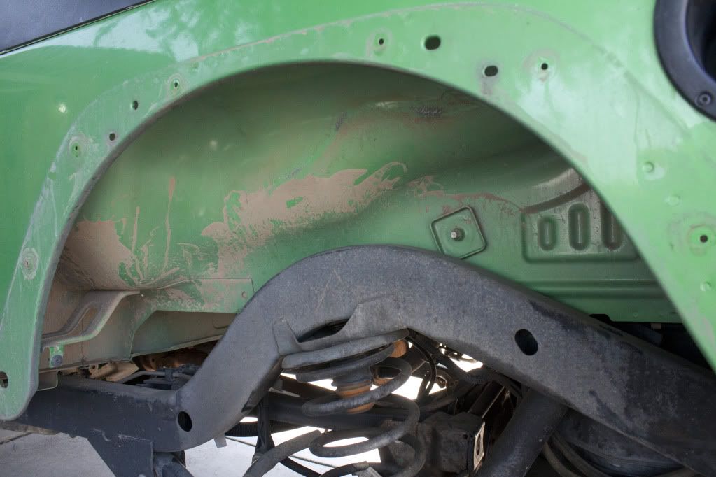

The rear was more difficult than the front, not necessarily hard, but you have to remove the wheel well insert to be able to get to the plastic nuts for the fender. To make this easier I removed my rear wheels altogether. (I took the time to go ahead and do a brake job while i was in there.) The insert is held in place with some christmas tree push pins. I just yanked on it hard enough to pop them off. With the insert out of the way taking the fender off was a breeze.

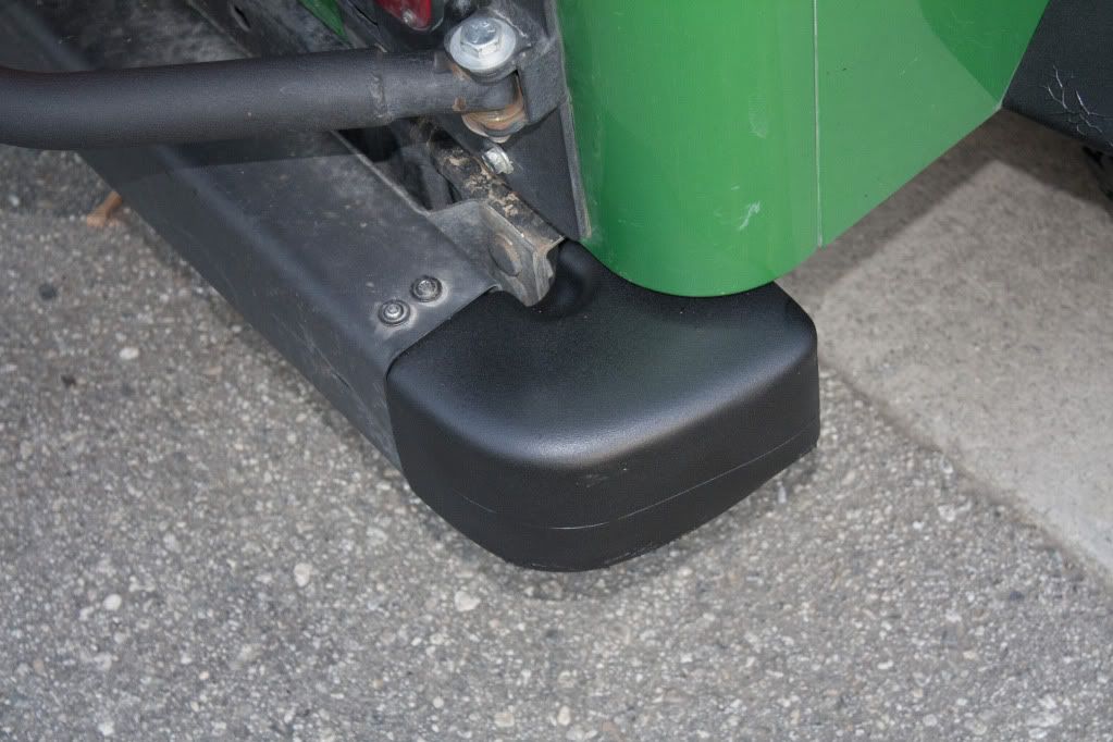

With the fenders off I scrubbed them down with simple green and a terry cloth. Hosed them off and did a quick wipe with a towel. Afterward I let them finish air drying. At this point I needed to start prepping the plastic. I used a clean terry cloth and soaked it with Mineral Spirits and rubbed them all down to make sure they didn't have any residue left on them. To prime them I used Rustolium Plastic Primer. At this point I figured I was putting so much effort in I might as well do the side plastic rear bumper inserts as well. Only took 4 screws each, they use the same star bit as the hard top. Not sure exactly what size that is, i just tend to leave the bit in my screw driver in my on-board kit. I used 2 coats of primer for each fender, waiting an hour in between coats.

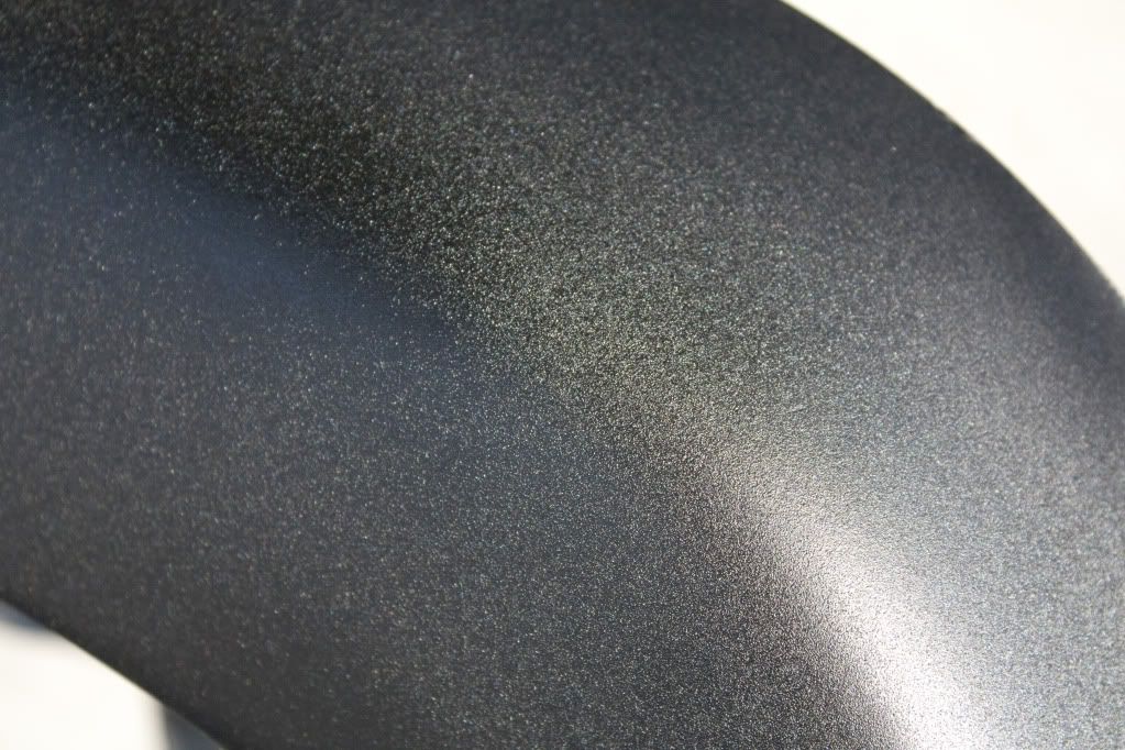

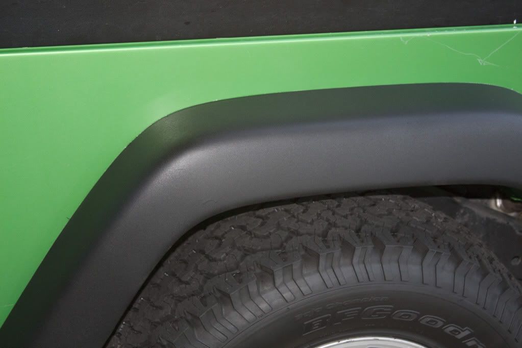

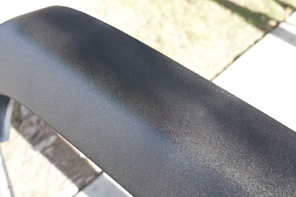

After the second coat of primer I let them sit for 2 hours before I applied the bed liner. I used Rustoleum Truck Bed Coating. It came in a spray can and only took an hour before it was dry to the touch. Though be very careful handling it, even after 2 hours I was able to accidentally smudge in a finger print when pressing in the bumper inserts. The bed liner only takes about 2 minutes before you can apply the next coat. So by the time I finished spraying my last piece I just started over again at the beginning. After letting them set for 2 hours I went ahead and bolted everything back together. I decided to heck with the wheel well inserts, looks better without them. But this does leave a hole exposing the rear cabin at the top of the wheel well. To avoid any water splashing up I just put some duct tape on either side. At some point I plan on having bed liner sprayed in the whole inside of the tub, and I'll take that opportunity to plug that proper, but for now duct tape will work just fine.

Anyway, I hope this helps out the next guy. I'll post a followup in a few months and let you know how it holds up.

That pile of dirt in the last picture came from the bumper insert. It was really kinda funny. The driver-side was full of beach sand and the passenger side was full of desert dirt. :-p

Thanks. :-) Yeah, I liked it so much I went ahead and decided to do my rock sliders the next day. Unfortunately you are supposed to wait 3 days for the Rustoleum to fully cure before you start applying real pressure to it. So of coarse while I was taking the sliders off I manages to scratch the flares a bit, that's ok though since I was planning on applying another coat next weekend anyway. I'll post pics for the sliders project in the next few days. Also, next weekend I think I'm going to go ahead and do my bumpers and lights. Pretty much everything that's black and faded is going to get a few coats of this stuff.

Does it have a rough texture like bedliner? I want to do something like this but want more of a flat black to match flat black rims im getting.

I used the Rustolem on My TJ & Yes it does have a fine texture so far it's holding up great did them 3 months a go.

I did my fender flares last summer, with the same bedliner paint. They're holding up quite well; I have a few chips on the leading edge of my rear flares, do to the "sand" they use here in the winter on roadways (rocks bigger than I have in my driveway!)
And I love the texture! It's not too rough, not too smooth, not too shiney, LoL!

It's been over a year since I sprayed mine with Rustolem Truck Bed Coating & They Look as good as the day I sprayed them.
