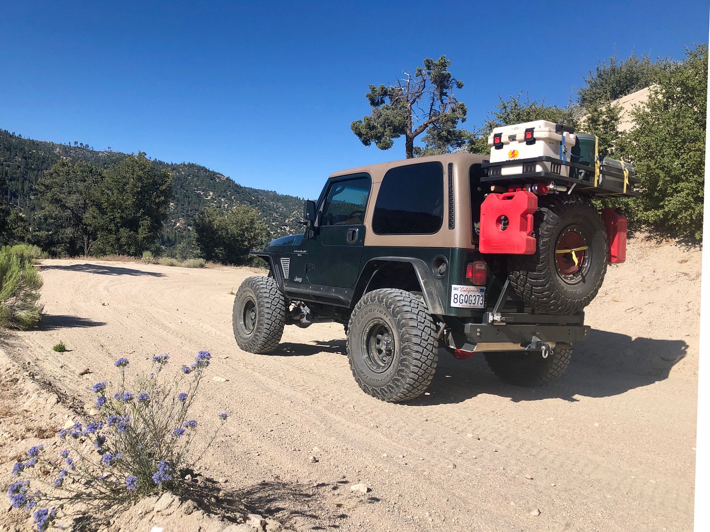

My TJ has developed a nasty sag and bottoming problem as it gets out fitted and loaded out. I have the synergy/poly outboard kit and plan to fit 12" shocks in there. Still, it will sag, probably not bottom but still sag. I have not put the rear armor on yet.
I'm running a rubicon express 4.5" longarm kit. The springs are spec length when unsprung. I have put in a metalcloak spring relocation kit that netted 1/4" up and I added a 1/2" spacer. Those are the nutshell details
Would putting a pair of 5.5" re springs "fix it"? What do you overlander types do to keep out the sag?
I'm not looking to "take stuff off" that others think I don't need, lets not roll that path. I'm looking for a solution to the sag. THANKS kindly!

Carry less. That's a lot of stuff. Seriously.

That said, it is 6gl of fuel, a spare, (pelican) 20qt ice chest, 2gl of ice cold water, picnic basket, shovel/axe and a 30' strap (which was an after thought).
All the stuff needed to make a perfect day. Nothing like an ice cold drink out of a rotomolded chest and a sandwich with all the fixins on a picnic blanket tucked off the trail.

I get that. But you are doing an outboard with tuned shocks, so performance must be of some concern. That Beverly Hillbilly pile hanging behind the rear axle is screwing up far more than just your rear ride height.

The max payload for a stock TJ is 800lbs. Air bags are probably your best bet to deal with bottoming out but your performance and handling you still suffer. You probably have 1/3 (or more) of that out past your bumper, about the worst place to have it. Your jeep will always handle poorly when loaded like this.
I do so long weekend camping trips (overlanding to some). I did the load the **** out of my jeep thing a couple times but stopped. I tank a tent, a change or too of clothes, non perishable food (no ice chest, bottled water with flavor packets and 5 gallons of gas. If I go comfy camping I load up a trailer. There is a reason the Land Cruiser / Range Rover is popular for true overlanding and not the TJ.
Best solution for carrying all the stuff is buy a different vehicle.
