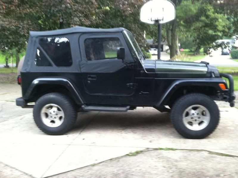

Stock with 31 inch tires:
RC 2.5 lift with same tires:
Coils are kind of light gray in color
