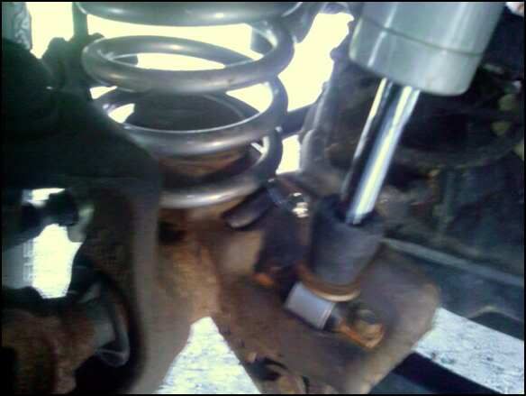

jalbs
Join Date: Apr 2005
Posts: 91
Originally Posted by mikeb683 View Post
mine was doing this originally but then i discovered i didn't have it resting in the retainer on the base oooppps, it didnt take long to find one trip down the road and i could hear it slipping of the axle. If thats not it maybe upside down? not really sure, if neither one of those works i would call rc
Problem solved and thanks for the help. It was not in the retainer correctly and needed to be turned a couple inches. Funny thing is I sent a pic from the jeepforum to show how it should look and he thought they lost the retainer clips. Somehow he came up with some in 20min. Doesn't look like they will hold anything but doesn't hurt:
Fixed sorry bad quality:
Glad you found the problem, easy fix eh !
