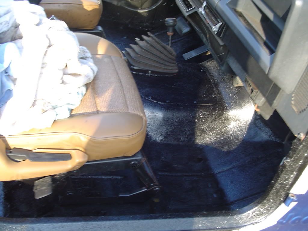

I have done 2 jeeps now and a p/u bed with the do it your self kits. One is Herc and one a brand Walmart carried for 1/2 the price. Both so far seem to hold up fine. Mind you I just did the Walmart kit a week or so ago. The Herc Jeep is over a year and several swamp runs (2 a month at least) etc and no issues.
Do it your self but take a full weekend to pull everything and strip prep etc then pain the next day and wait 24hrs before putting the seats etc back in. I let mine bake in the FL sun topless for a day and that helped cure it.
the Herc is much thicker. The TJ will be a street beach use mostly so I was nto concerned with it. I did spply 3 coats of the stuff.
Just a few pictures if you want to see more check here
