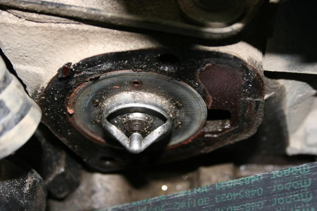

This is a thermostat and its gasket.
...more to come...

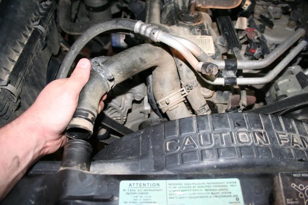

Step 1
Place a bucket under your jeep, right in the midde and a little behind the radiator.
Locate the thermostat housing, it is the metal thingy where the 2 hoses connect, right behind the fan blade.
Unhook the large radiator hose. This will give you a little more room and flexibility.
There are 2 bolts, one in the front center, and the other at the 7 o'clock position. That will be a little tight as the serpentine belt runs right next to it. Unbolt both of them. Coolant will drain out! Adjust bucket as necessary.

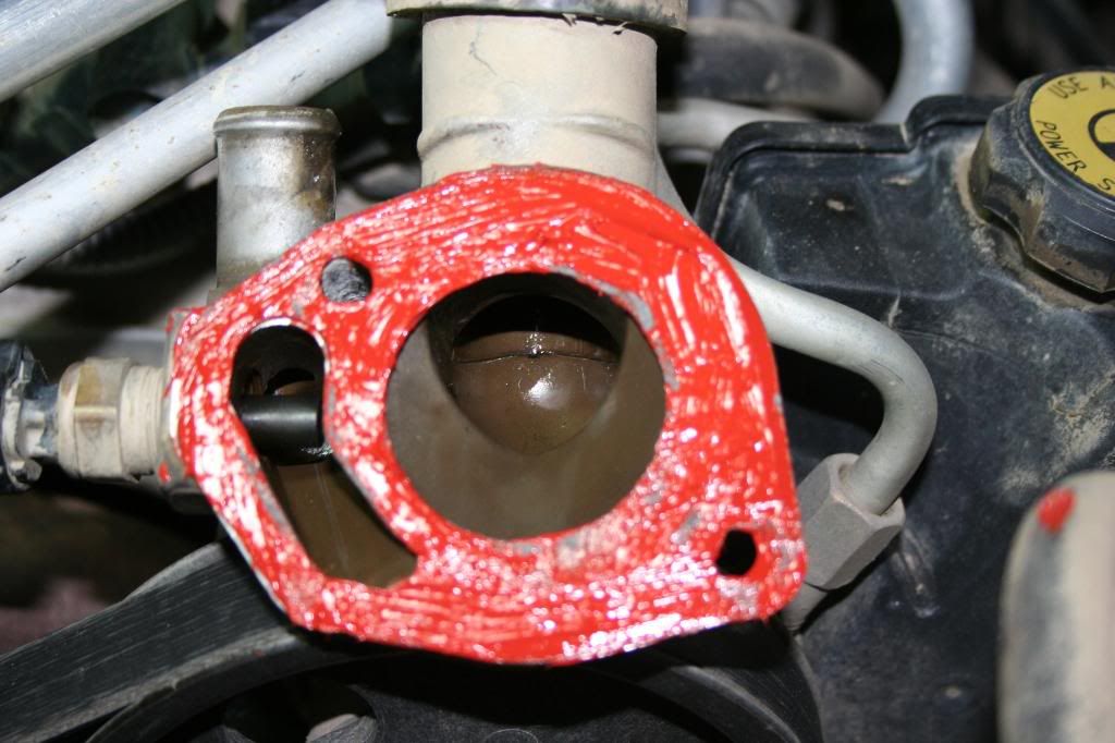

Swing up the manifold and scrape off the old gasket.
Make it pretty!

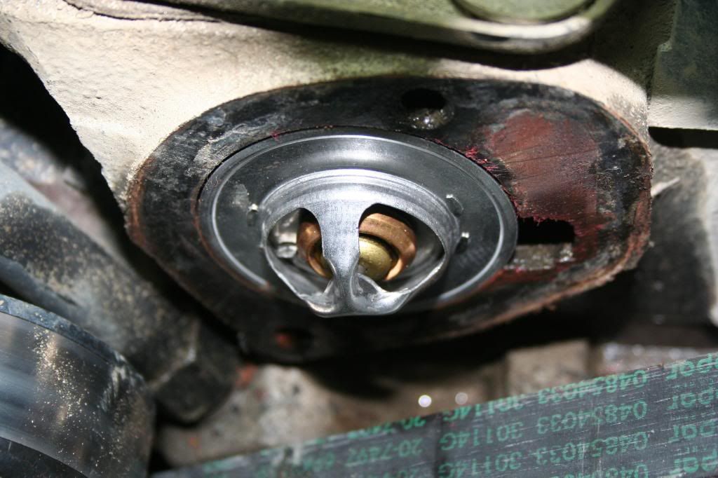

Pull out the old thermostat.
CONGRATULATIONS! You are half way done!

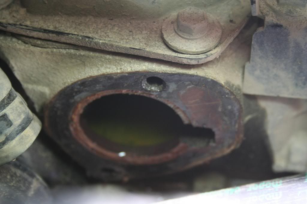

Oops....a little more work. Scrape the old gasket off the big hole down there. Also, the thermostat rests on a little recessed ledge. Can you feel it? Yep, wipe all that old gunk out of it.
Back to the manifold. Smear some RTV on the gasket.....both sides!!
All right! You're doing great. Grab the new thermostat and put it in. Careful. Line it up.
Great! Now put the manifold back over it and bolt it down. Top off your radiator with the 50/50 mix.
