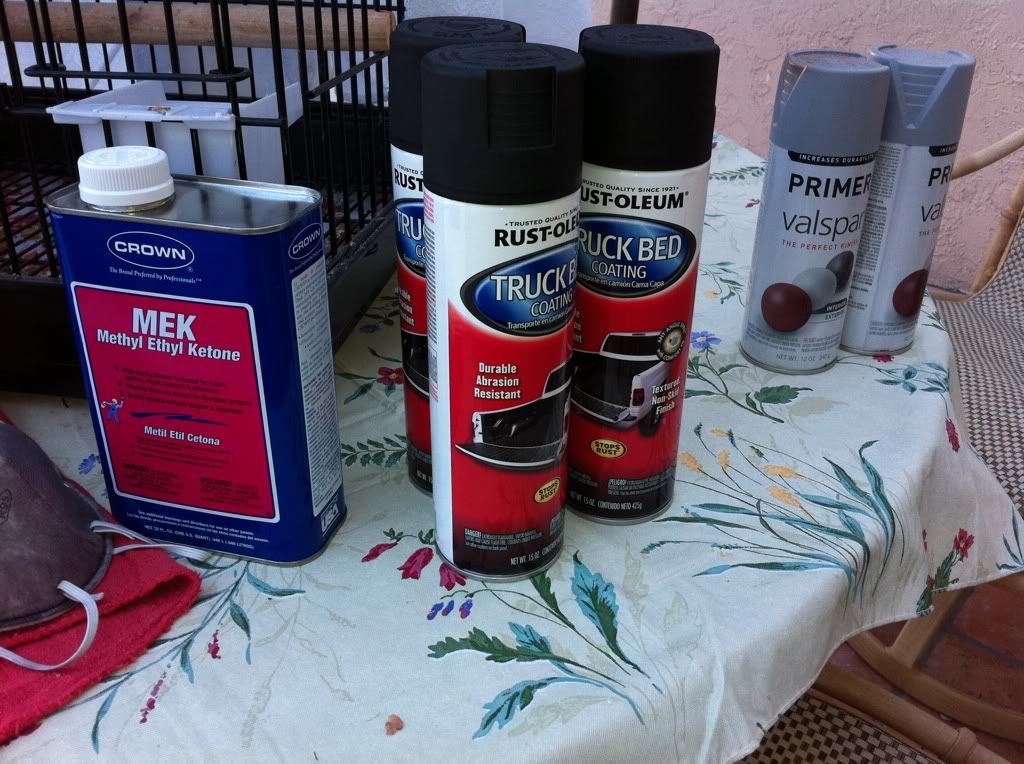

Then I went to Lowe's,... topless , and bought
1. Pack (5 sheets) of 320 grit sandpaper
2 cans of Valspar any surface primer (only ended up needing half of one can)
5 cans of Rustoleum spray on bed liner (first coat took 2 1/2 cans next coat took ~2 cans)
the smaller can of MEK
This badboy..
These gloves
and a good mask

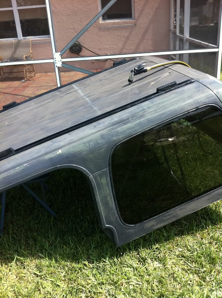

First thing I did was wash the top with warm water and soap and then dried it off... nothing special

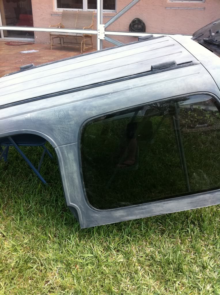

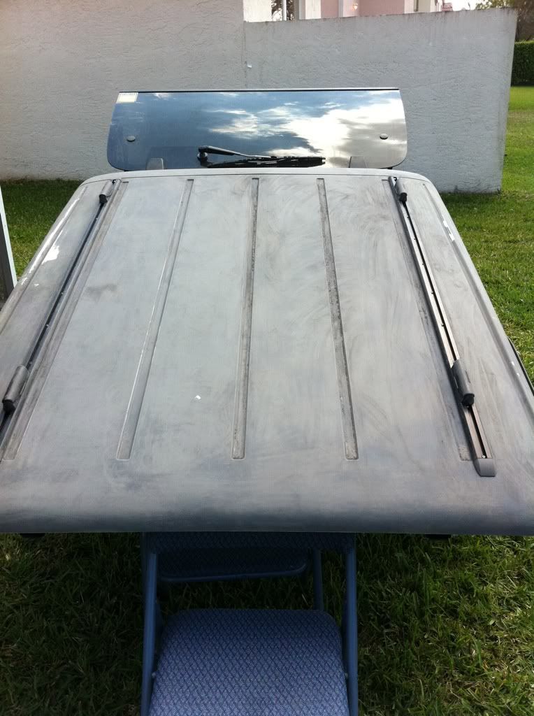

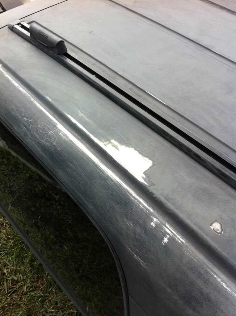

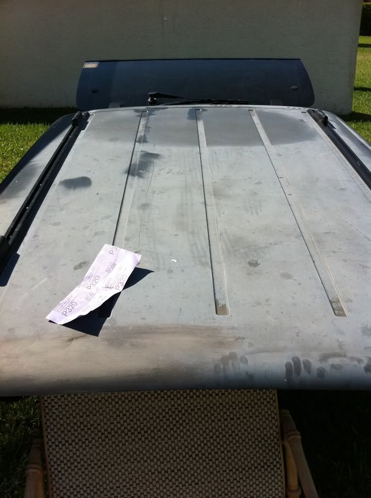

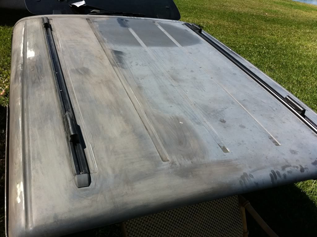

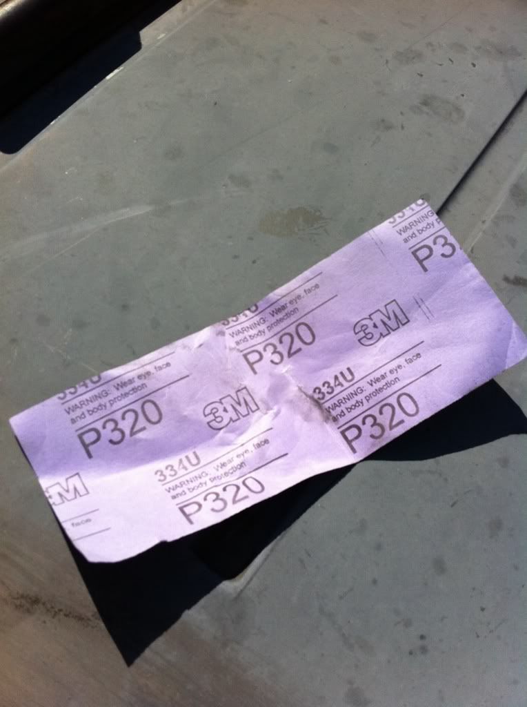

Then started sanding, its important to wear the mask and eye protection here!
You can clearly see that I'm halfway done sanding here
This is why I bought primer.... didn't want to paint directly on any fiberglass

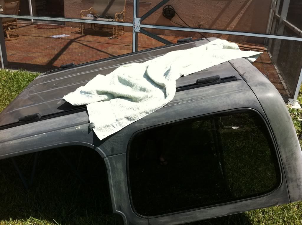

Then I rinsed it down with the hose really good, made sure to spray all the little nooks and crannies, and here you'll see what you sanded good and whre you missed...
Dried it really good

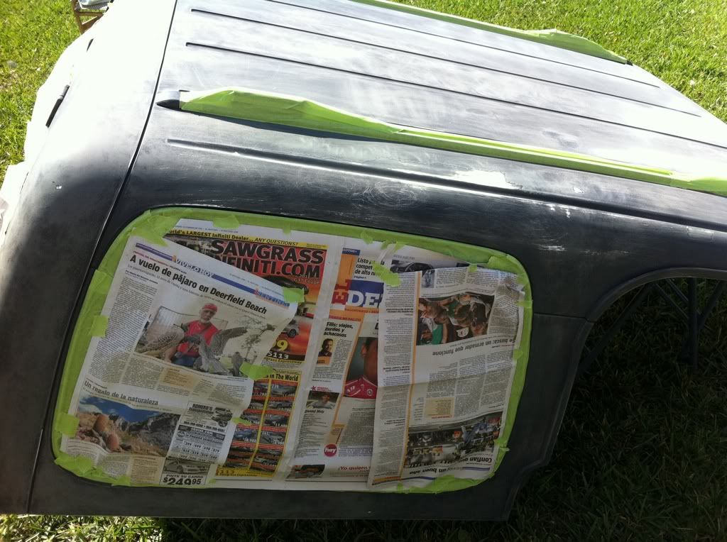

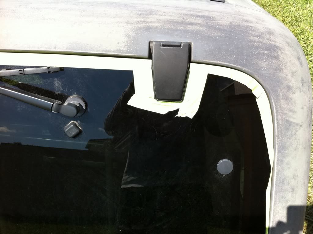

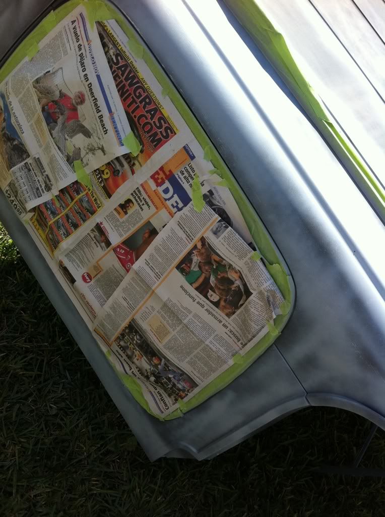

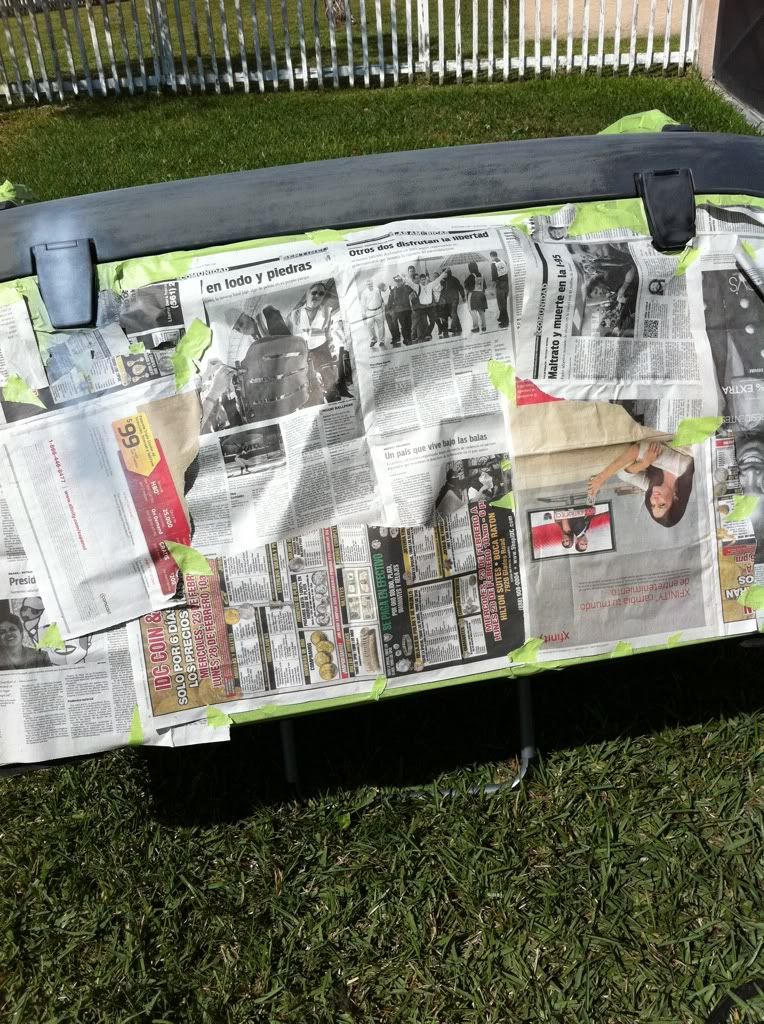

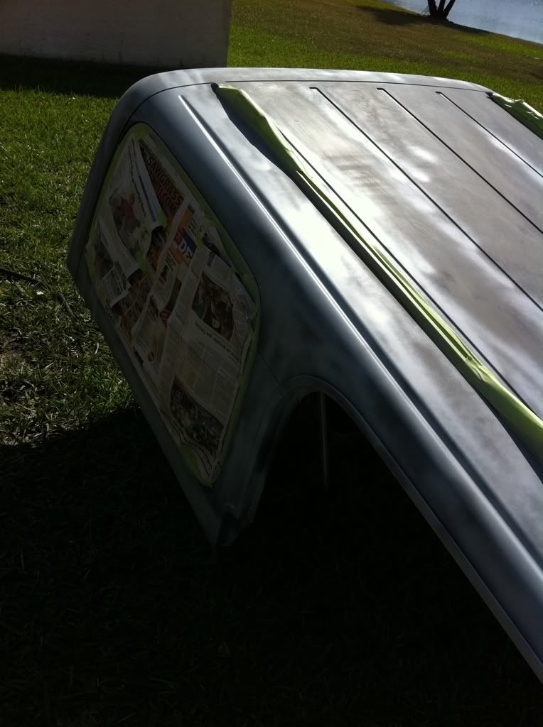

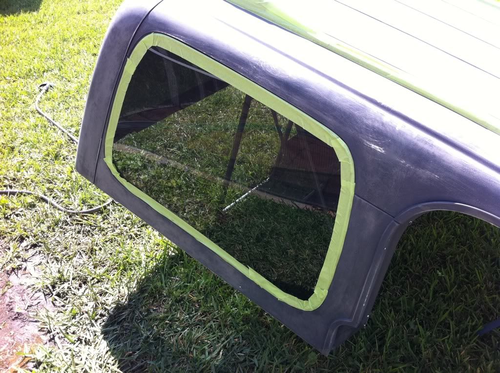

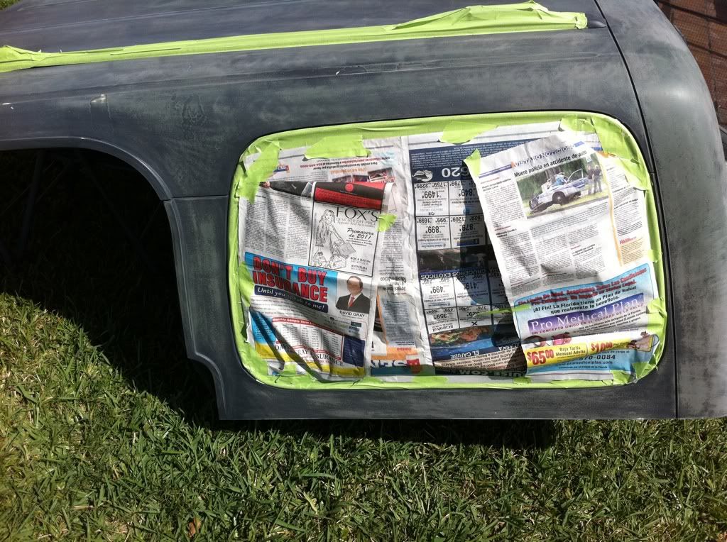

Started taping! I had a roof rack so I taped that off, you might not have to if you dont have one!
Then I went over everywhere that I could see fiber glass with primer

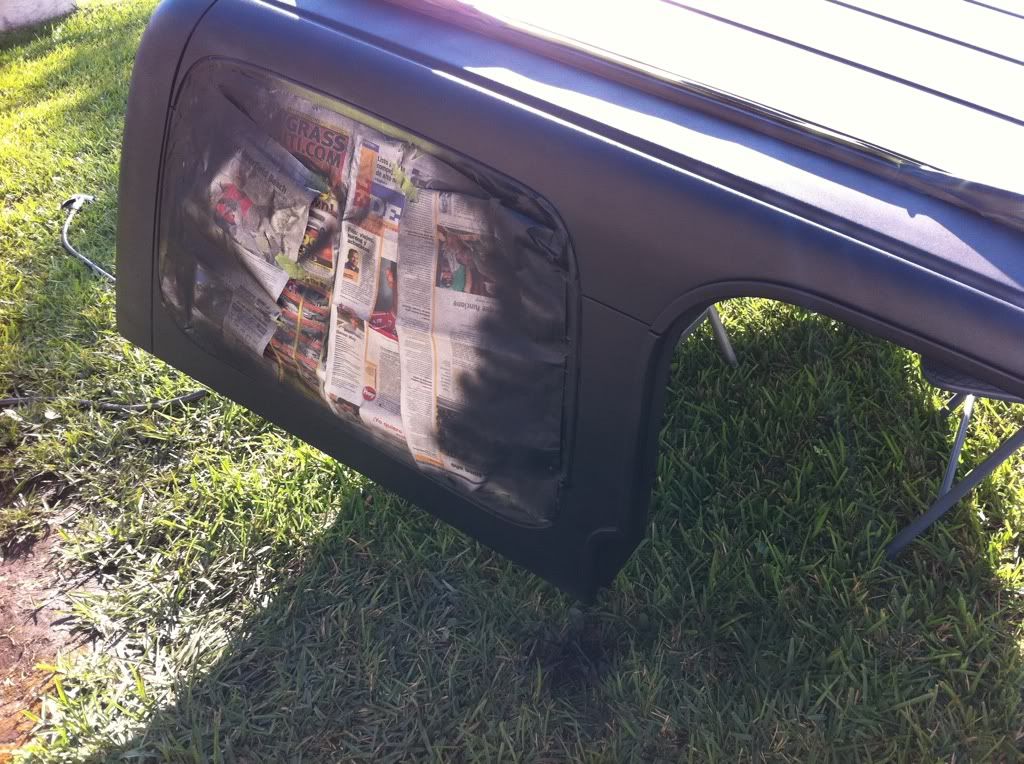

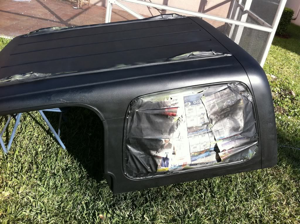

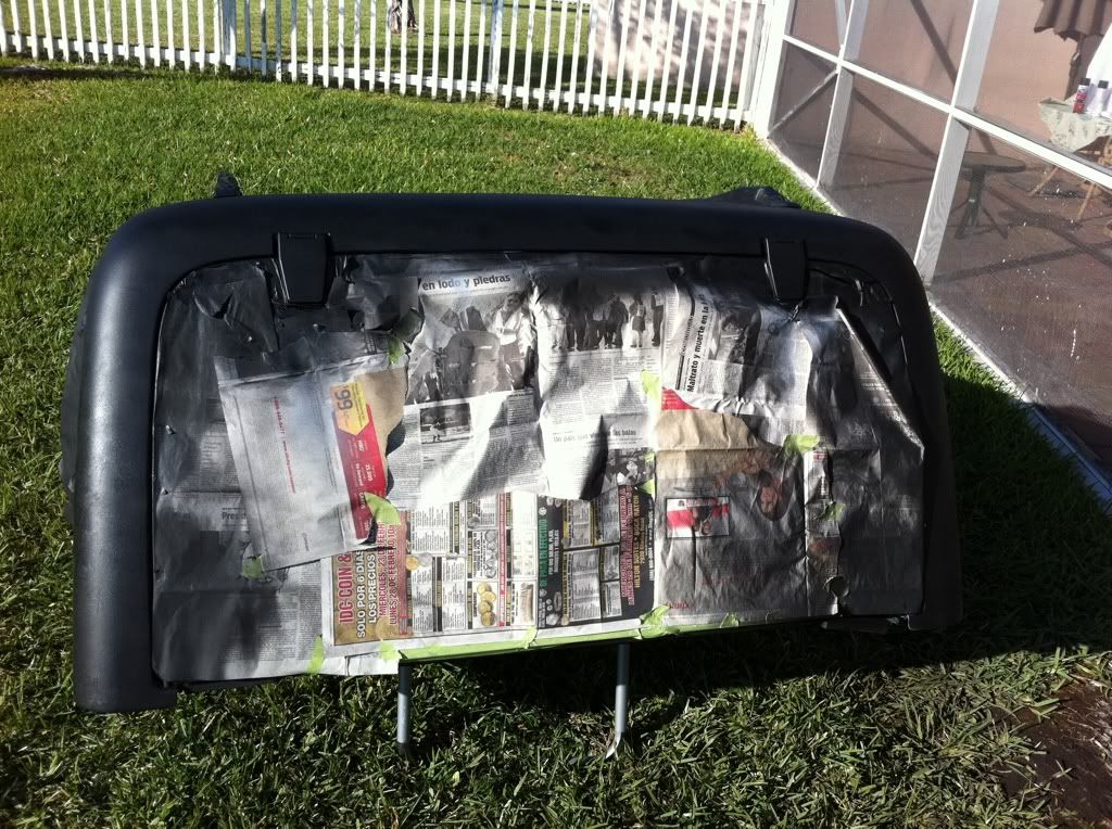

Then I started spraying the bedliner... if you mess up use the MEK on a paper towel to thin it out and clean it off. I did this a few times.
Some things to remember about the 1st coat. It is the first coat so its not going to look completely even, thats okay. Don't try to over do it and end up with it being runny.
how the top looks with 2 coats
I waited 30 minutes after primer to start painting and 2 hours between coats of paint.

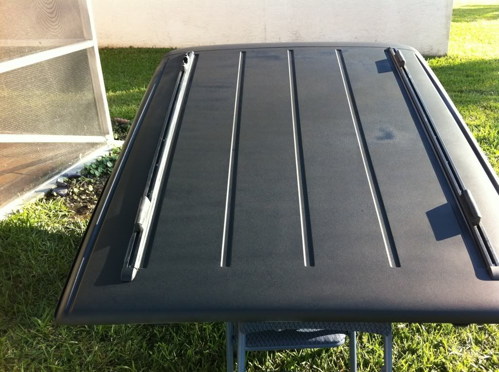

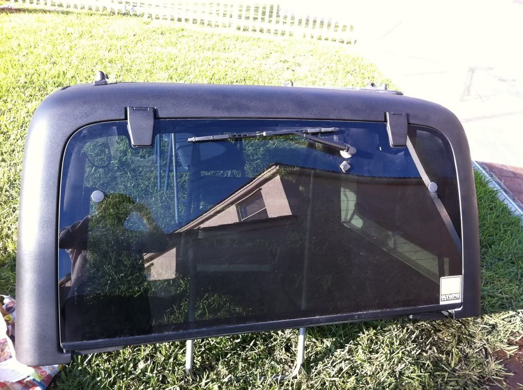

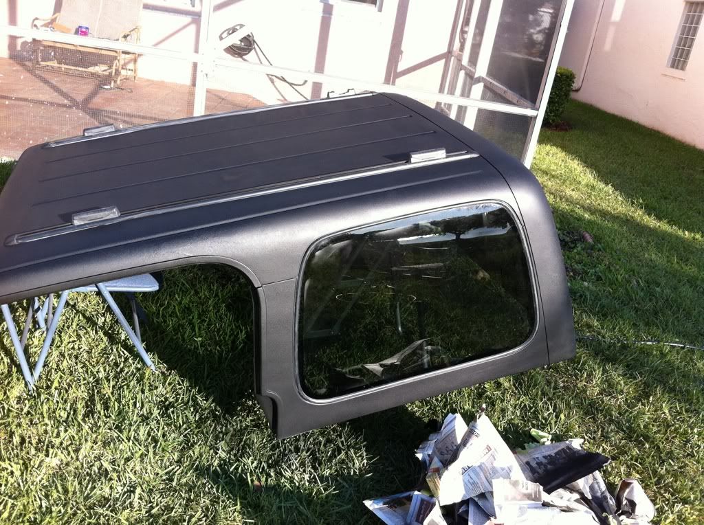

here she is done
This is why its important to wear eye protection and a mask...
you can see everywhere on my face that wasn't covered is pretty much black with dust and overspray..
Lets review: Take top off, wash top, sand top, wash top again, dry top, make sure sanded everywhere good, tape off windows, paint light first coat, spray even 2nd coat, touch up, pull off tape and you're done.
It's really simple and hard to screw up....

What color was yours to start with? Can't tell if it was black or gray. I did mine a few years ago.
- Start by spraying the recesses around the side windows and in any creases. I have had some flaking in those areas probably because some overspray goth there before I gave those places a coat and it did not bond well.
- Take the rear glass off and weather strip, that way the inside of the opening matches. I taped sheets of newspaper across the opening, to keep overspray out of the inside, particularly if you are leaving the white interior. I painted my interior.
- The same around the front and door jambs, tape long pieces of newspaper around the front.

It was grey and had black spots on it from the PO
I didn't take the rear window off or weatherstrip because it wasn't necessary, and no one was going to see there but me so (to me) it didnt matter.
Also I didn't take the weatherstripping off the side windows because it can never fit back the same, at least for me.
I meant in the rear hatch, not the side windows

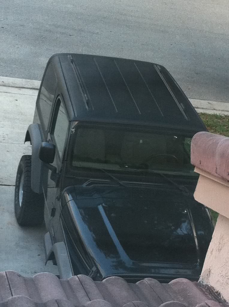

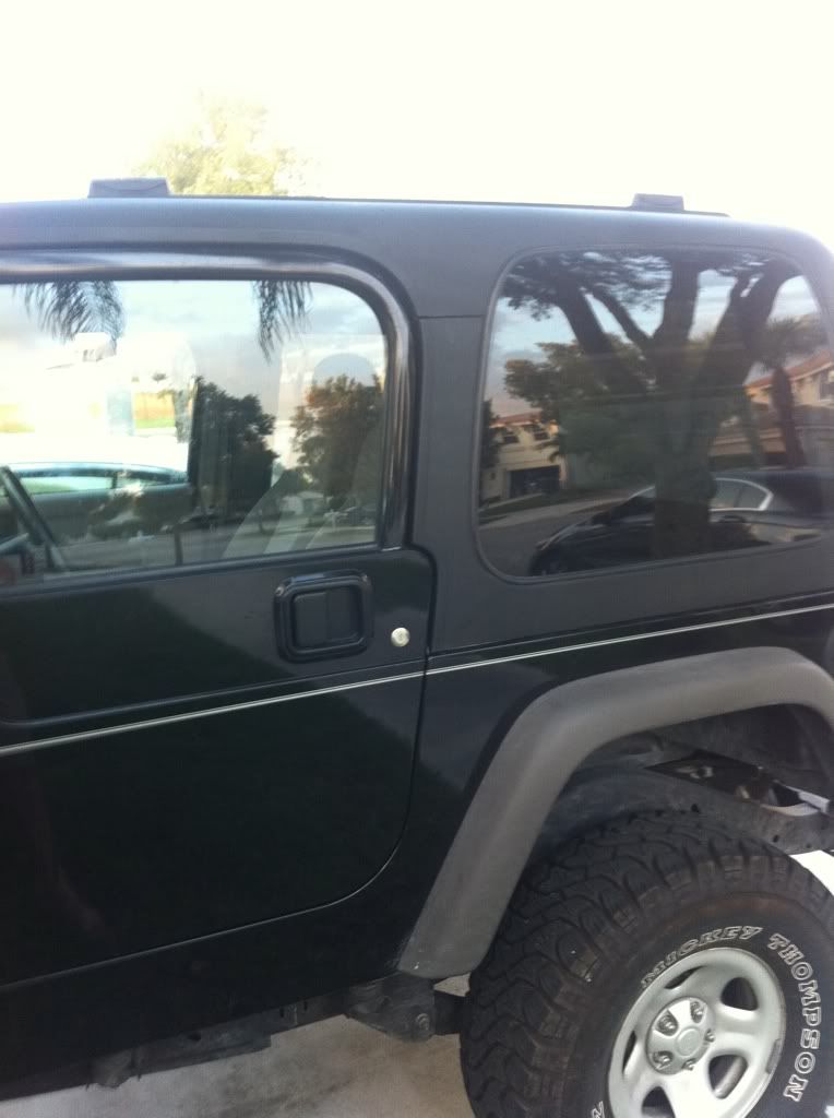

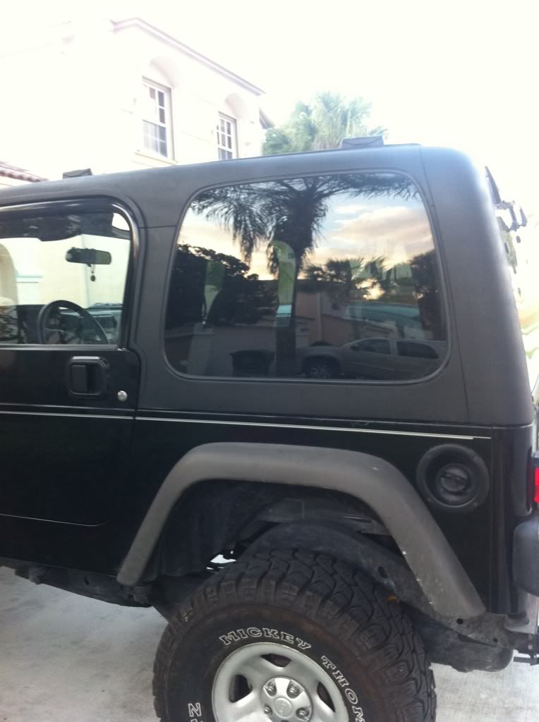

Here she is mounted back on the Jeep like you asked for
And an aerial view for good measure lol
I guess I oughta be paint my flares soon lol
