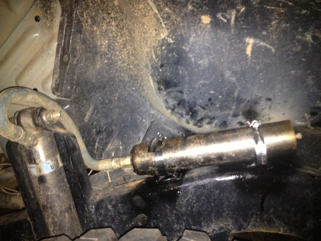

there is no "set" time in which you need to outboard your rear shocks. My friend has a 7 inch stretch out back and still has not outboarded the rear shocks, and his jeep works just fine on and off the road.
I think the best time to do it is when you have the rear suspension all torn apart, swapping rear axles, etc. I outboarded my shocks when i did my stretch, 8.8 swap, and 4 link. I would recommend it to anyone, but will say if you do it dont go out and buy your general white body shocks. Buy quality shocks so your results will be desirable.
Here is a pretty dirty picture of mine, but shows you where i put it.
