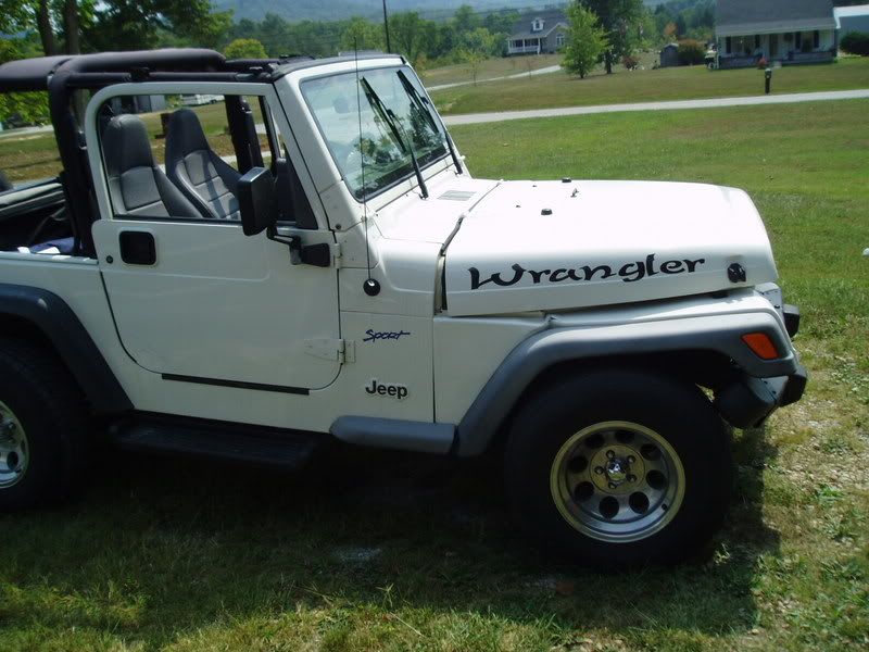

Well, this should be interesting, but Im starting from ground up, soI thought I would start a new thread so you guys could follow the build from the start. Im sure its going to be a long, long road filled with many questions, but I will be using this as sort of a journal for the build.
Just a little background, I have a 98 TJ that I wrecked labor day weekend. I missed a stop sign late at night and hit a rock imbankment head on at about 30 MPH. Had a some frame damage and busted up the engine, busted the front suspension, and some other stuff. The only body parts damaged were the fenders and bumper, somehow. All of the grill, hood and the rest of the front end came out unscratched.
To the point of all of this, I was able to pick up a straight frame from a theft recovery. I am patiently awaiting its arrival today. I will post pics as it comes along. I don't really have tons of spare time, so it will take a long time im sure. Here are a few pics of the jeep as it is now.

whoa...that's one messed up jeep. You must have gone up on the rock cause the whole front end is turned upward. Good luck with the build!!!
