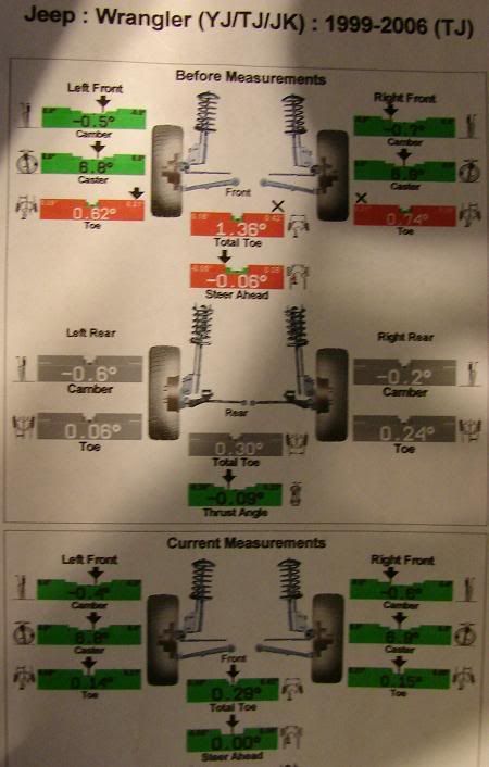

heres some pics of earlier went and picked up the parts. total cost for both tie rods and adjuster sleeve from a v8 grand cherokee and can of PB blaster and a tube of grease was $89 with tax.
by the time I got home with the parts the ground pretty much melted and the sleet turned into rain. heres my work area
i know, so luxurious
took about an hour total time to remove the old one, put the new one together and bolt it in and adjust it so its semi-straight for the ride down to alignment shop.

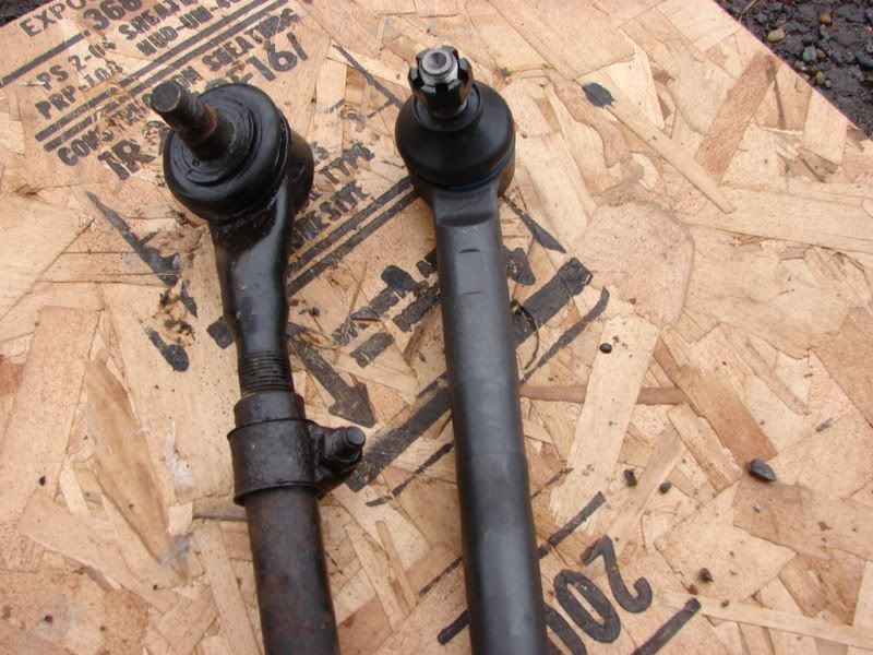

to give you guys an idea why this swap is worth it- This is the stock TJ rod its about 7/8" diameter and HOLLOW! no wonder it couldnt take much.
The ZJ tie rod is 1" SOLID steel
old tie rod on the left, new ZJ tie rod on the right
Besides a bigger solid steel rod, the ends are also bigger
new adjustment clamp compared to old stock TJ
how it looks complete (well didnt have adjustment clamps on it)
