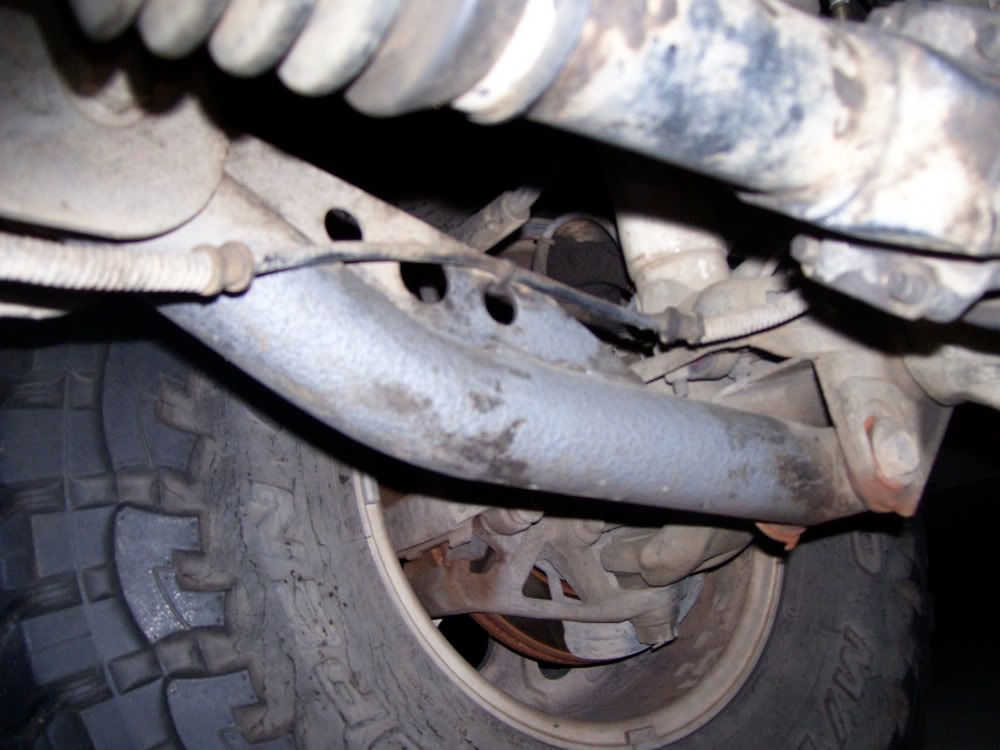

First off, I DON'T want hate comments on how I'm running ProComp lower control arms with bushings at both ends. Yes I know it doesn't flex as well as joints and has the risk of tearing off the control arm mounts. When we bought the Jeep this is the lift it had on it, and I don't have the cash to spend on 2 pairs of new arms.
Anyways, I need help. I was wondering what do I have to do in order to change out the bushings? Do I need to lift the Jeep and rest the frame on jackstands? Do I need to take off the tires and rest the axle on stands? Can I just go at it without putting anything on jackstands but do one arm at a time? What is the prep work? Thanks,
- Josh
Here is a picture of the arm
and the f'd up bushings

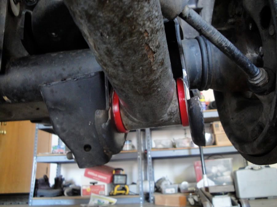

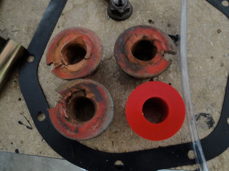

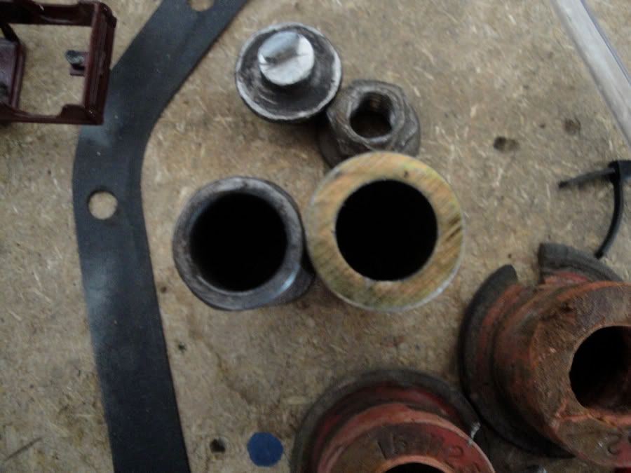

Got one side fixed. I had to cut the LCA bolt off because for some reason 4WheelParts installed it so if you try to take it out it hits the brake drum. So instead of having to take off the drum I just cut the head of the bolt off and slid it out the other side. I put the frame on stands just to take some weight off of things. Well here's some pics of like the old bushings, the old crush sleeve, and installed.
