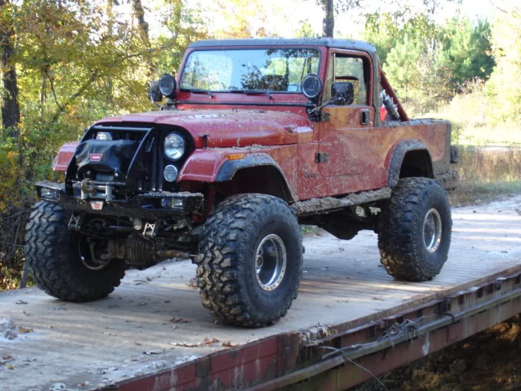

Here's a LJ stuck pic:
Cool pic! Your not really stuck are you?
