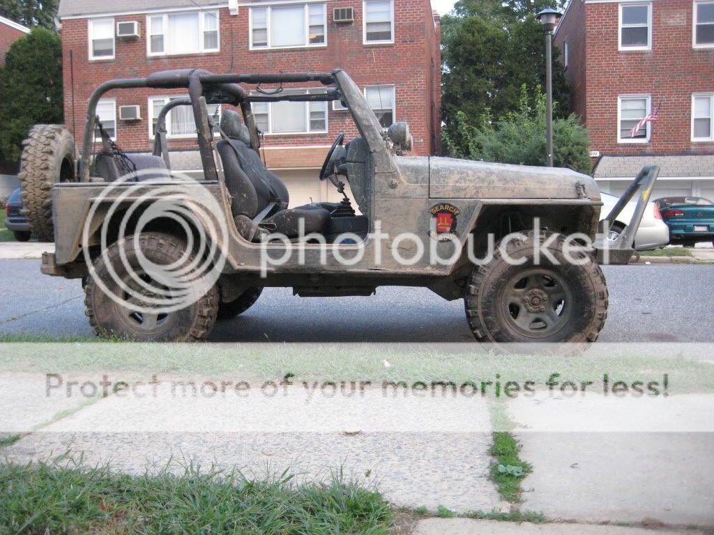

funshootin1
Location: philadelphia
Posts: 722
sunfire lol, same thing. gettin my moneys worth out of it thats for sure. tires do rub when the bumpstops compress, seems to happen alot lately.

Originally Posted by funshootin1 View Post
34x10.5 ltbs, stock cherokee wheels, 29spline 8.25 zjdisks welded 4.56, hp d30 welded 4.56 cad cable mod. poop pipe tube fenders, boxed control arms 2 inch procomp springs.
That looks/sounds like something that would usually be done to a beat up XJ, not a TJ....
On another note, how is the 8.25 holding up?

post #36 of 55 Old 09-23-2010, 04:52 PM
funshootin1
Posts: 722
8.25 holdin up fine, Im sure an 8.8 woulda coulda shoulda but this was layin around so I geared and welded it , its 29 spline with zj disk on a 4 banger, spares are in the garage jic . swappin axels isnt that big a deal for me but for anyone payin to get it done on a jeep they care about.... I would reccomend 8.8s for peace of mind. Check out treadwright for tires...couple of our guys are runnin them they have lots of metric sizes that are around 32 to 33 inches and 10.5 to 11 inch widths, alot in 16 and 17 inch rim sizes not much in 15. great tires, hold up to hard wheelin and good on the road. im swichin to 16 inch rims and doin 285,75,16 guarddog( goodyear mtr, goodyear carcass and goodyear still written on sidewalls) they measure 33.2 and are 11.4 wide and stand that tall in the real world too, not like swampers that run an inch or so smaller than stated on the sidewall.
