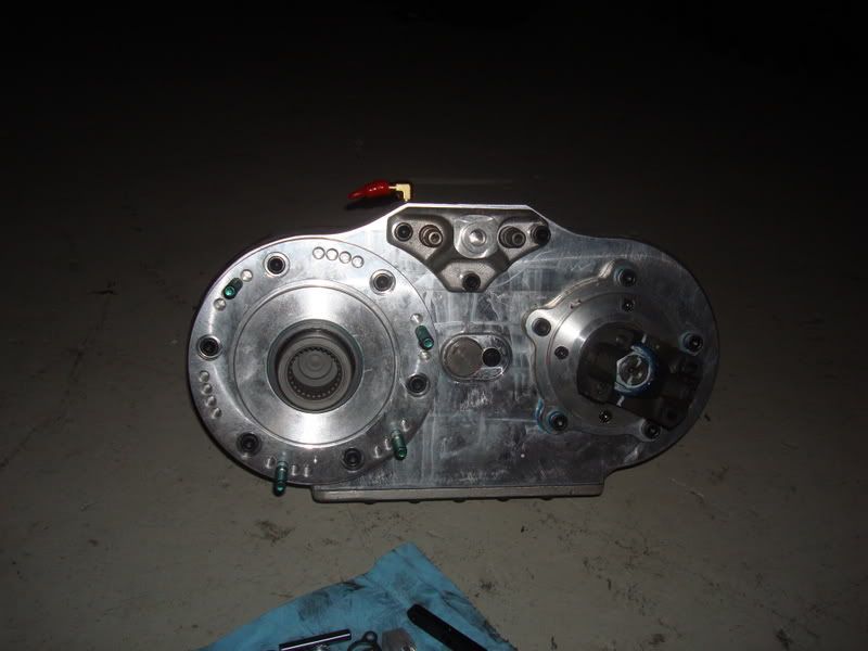

There it is on the flat bed
That happened around january of this year. Mind, you I was beating the hell out of it, fully aware something was wrong with it to begin with. I just didnt expect it to literally blow up on me. Call it stupid... call it carelessness. Ive been without a vehicle since then, so Ive payed the price. The next day I started ordering parts, and doing research.

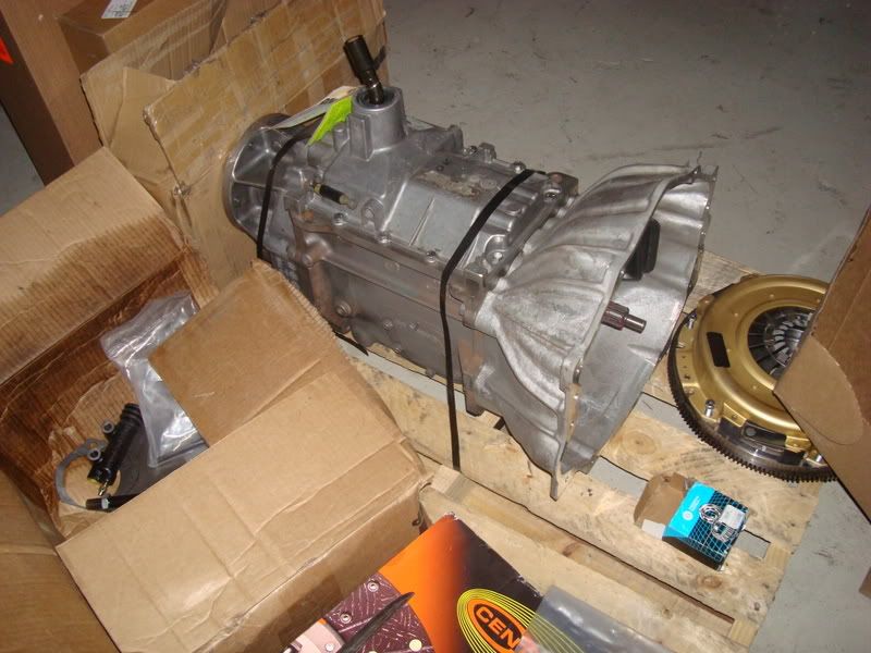

Now, I couldnt just put any old tranny behind it. It had to be something substantial, that could hold up to 400hp and 400ft/lb of torque. Here is the NV4500 out that I had custom built for me by Mantrans. These guys are awesome and would recommend them for anyone looking for a rebuilt tranny, or something custom built www.mantrans.com . They took the NV4500 and built it to mate to my chevy engine in the front with the 29 spline dodge output in the rear. They are also a certified Advance adapters distributor, which was a great help, when they told me they could also get me the custom bell housing, to match. Not only that, but they called advance for me, and talked to them to make sure there would be no issues in mating the Atlas II that I had ordered. And yes, thats a centerforce clutch to go with it
Heres the tranny

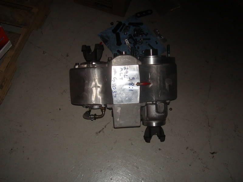

Now for the Atlas II. Again, advance is another company I will be doing future business with.VERY helpful. They did everything they could to make sure my order was everything I needed and wanted. Ordered my atlas with the 3.8 low gears. I also elected to get the brand new cable shifters that bolt right into the TJ.
Heres my Atlas II

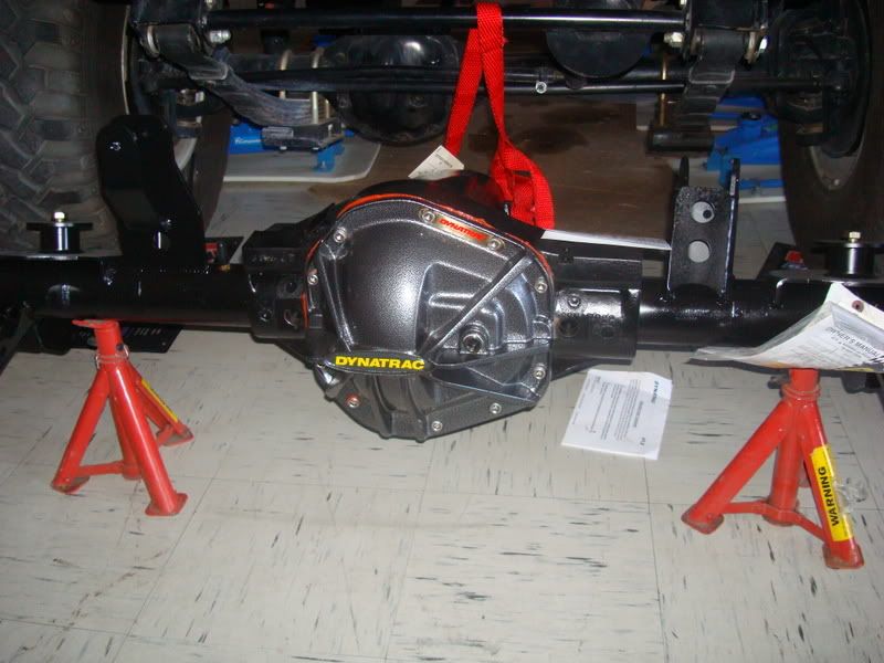

Now for the largest investment in my whole project. I couldnt slack on any part of this project. I ordered front and rear Dynatrac pro 60s. Although all companys were outstanding, Im going to say Dynatrac was by far the best. I told Steve what I was doing, and he helped me every bit along the way. They even gave me a military discount. I really cant say enough about customer support from dynatrac, A+ Anyway, I got the stronger axle shafts, and upgraded everything I could without shelling out the cash for the Pro Rock 60s. They are stuffed with 4.88 gears, and detroit lockers. I will be running 35s on them, possibly 36s.
I KNOW THESE ARNT PROROCKS THEY ARE PROS THERE IS A DIFFERENCE
Note - Yes these are my axles. The shop I have doing the swap asked if they could display them, because as you can see, they are gorgeous!

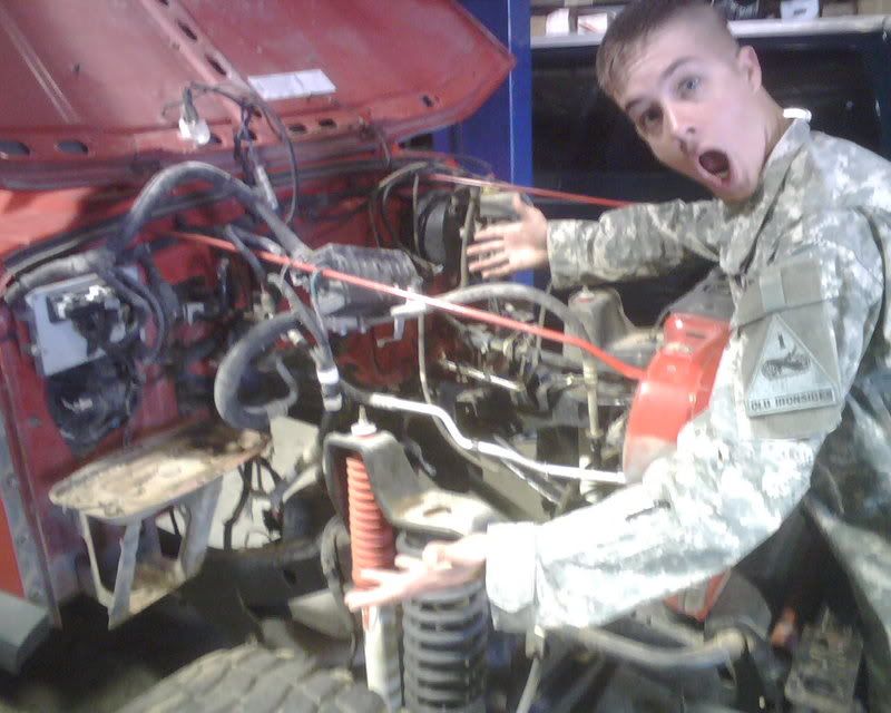

They have started tearing it apart *crappy cell pic* All I had that day
My buddy Payne.... hes excited. Cant you tell?

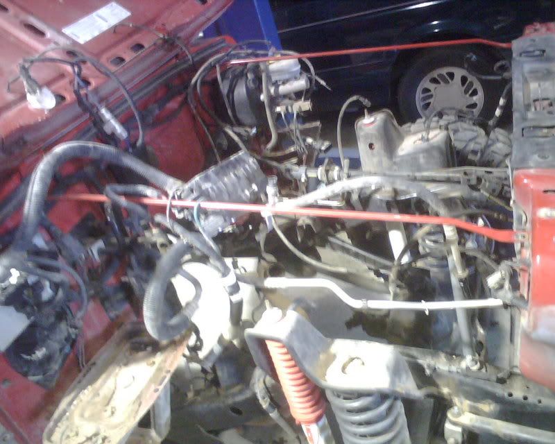

These were taking today
The Engine getting ready to be lined up, and dropped in. Bauer is also very excited. But Im pretty sure its because Im that much closer to him not having to drive me around anymore
And from the side
They wanted to have the motor mounts marked, and welded today, but the whole power grid went out while I was taking these pics. Engine SHOULD be ready to go in tomorow.
