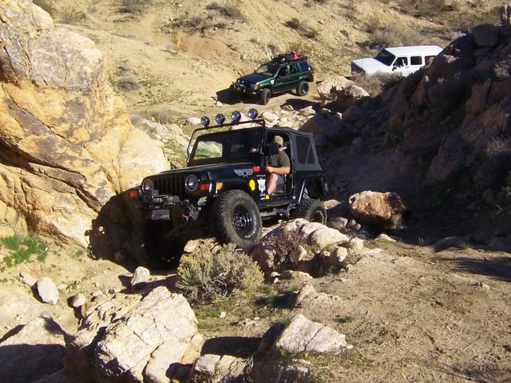

x2 on not getting the ez locker - mine was junk as well - had too many problems with it. I recently installed an Aussie locker - $249 shipped from northridge4x4 and this thing is awesome. feels like an open diff when in 2wd
https://www.jeepforum.com/forum/showthread.php?t=512950
my 2nd outing with it this weekend - ran it on a lot of rocks, lifted tires left and right and the thing performed flawlessly

Where was that pic taken?
