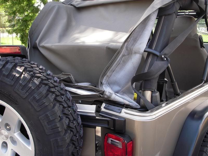

Several people asked how I folded my soft top down so neatly so here is a picture essay for those that want it to fold neater.
Step 1 open sunrider portion and fold it back neatly
step 2 remove windows
Step 3 fold up rear portion of top and fold it neatly towards center
Step 4 pull sunrider soft top pins to release top.
Step 5 begin to pull top rearwards folding edges towads center as the loose material comes down.
Step 6 pull next bow down on top of preious material while folding the edges of the material towards the center. Also begin to fold the next sections side material towards the center of the jeep
Step 7 pull the bow for the last section down over the previous material as you neatly push the side material towards the center. You end up with the sunrider portion folded neatly over the rest of the material.

Step 8 take folded sunrider section and tuck it between the soft top and the jeeps sheet metal.
at this point you can straighten out the side bars of the top so they lay a little flatter than in previous picture and close the sunrider latches if you want,
I leave them open so the bar is flexible.
Now take your doors off put on some sort of side mirror where required by law and get some time behind the wheel
