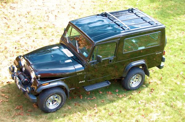

What about an XJ Cherokee rack? I know this Jeep isn't a TJ, but this shot from above shows how the Cherokee rack fits on the top of a CJ-8, it should fit fine on a TJ hardtop as well. The nice thing about the design of this rack is that the longitudinal rails have removable plastic end caps, which means you can cut the rack to any length you want to fit on a TJ top. Plus you'd have a "factory" Jeep rack You can also re-use the rooftop plastic strips from a Cherokee with new double-sided automotive tape.
