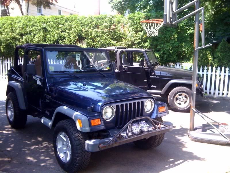

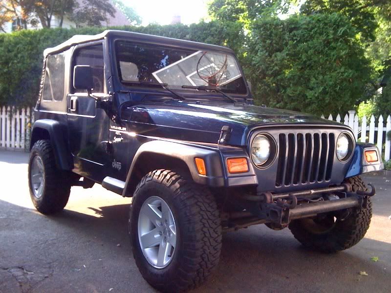

I just figured Id share a pic of my new and old TJs (the black one is my 97 4 banger and the blue is the new 2000 4.0 with 75K)
The 1st pic was last Wednesday when I bought it and the next pic is after some work this weekend (flares painted and me replacing the bumpers and wiring new HID fogs (bumper and fogs will be on later today though)
