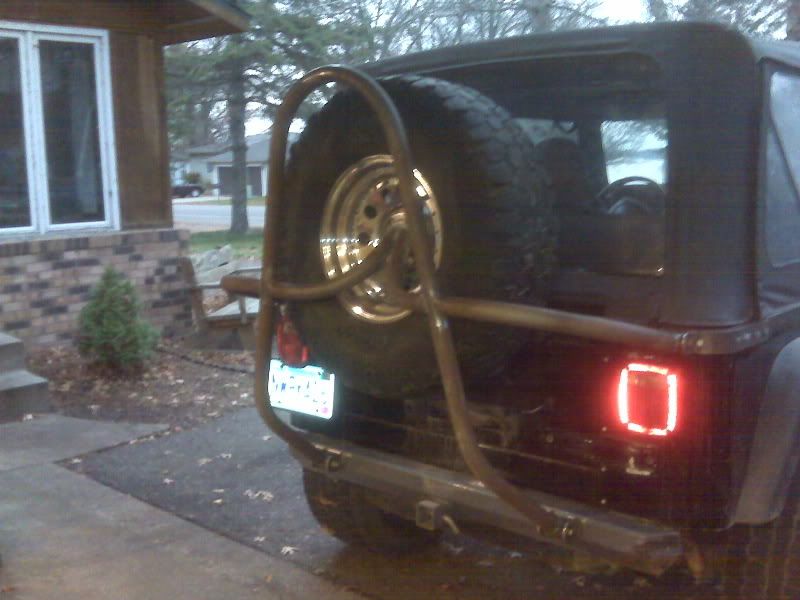

I built a rear stinger/tire carrier too... Still have a little bit of work to do. Might add a few tubes to support a skid on the lower portion, like Poison Spyder... I'm thinking I might install my air tank under the tire for my OBA... Kinda looks like I'll have to build my own tank/s, there's not enough room for one of those portable air tanks. Obviously it still needs some grinding, prepping and painting.

That's a MEAN looking carrier, ment in a good way, ,
It is a little late now, but why did you mount the tire that high?
and BUMP
Well to be honest with you, when you're a tube bending god like me, NOT! sometimes you're happy with what you get...

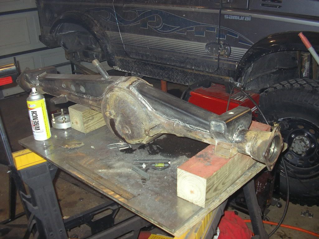

Has anyone made any rear D35 axle braces? I was thinking about it and looking for some ideas.

I've never done a 35 but back a few years ago when I had my Zuk I trussed up the axles...
I just started with 2x6 3/16 wall tubing, cut out the contour and welded it on... Weld a little, let it cool, weld a little, let it cool and so on, and so on, and so on,and so on, and so on...
