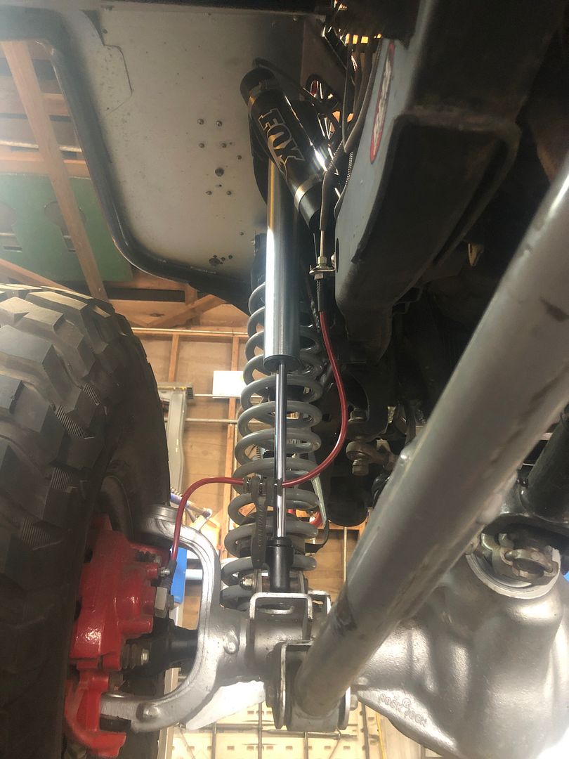

To follow up on some of your questions and maybe expand a bit, Fox has a new(ish) adjuster called the LSC (low speed compression adjustment). They are well suited to playing in the rocks. Unlike the Rancho 9000 shocks, these really work. At zero or the lowest setting, the shock is a bit spongy, on the highest setting (11 I think) it is fairly stiff. On rock gardens and other rutted trails, I will run between 2-3, when I'm aired up and back on forest roads, I'll set it up to 7ish. I bought mine (tuned) from Fullstack MS (Paul). I'm running 11" in front and 12" in back. I am not sure how to rate the shock on road as our rig is towed to the trails. I know they are pricey but they work really good.
See blue adjuster on top of reservoir:

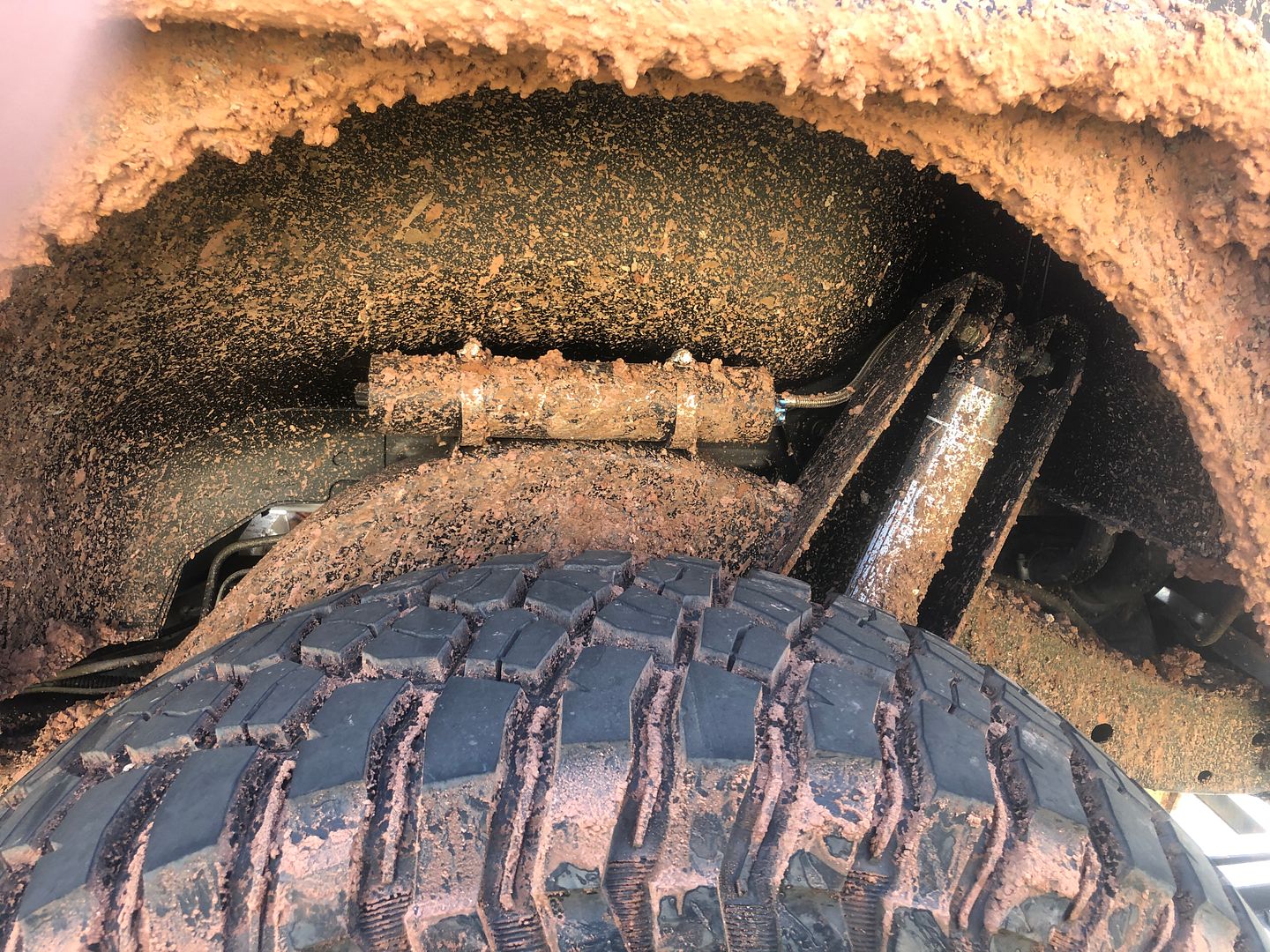

Just noticed this thread. In the above photo I was running the now discontinued OME Nitrochargers and they were superb. When they finally gave up the ghost I was talked into trying Rancho's new gas-charged RS5000x and they blew me away, they seemed to be the OME Nitrocharger reincarnated. Great shocks. Then after a year or two I replaced them with adjustable RS9000xl shocks thinking that'd be better since I tow a trailer a lot and I could stiffen them up. Turns out I liked the old RS5000x shocks better than my present adjustable 9000xl shocks. If I could I'd swap back to the RS5000x. Oh, I didn't replace the OME Nitrochargers with the its replacement OME Nitrocharger Sport because their new Sport rides a lot stiffer.
