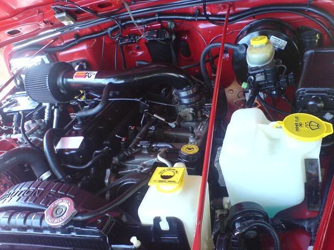

I swear by Lestoil. I have been cleaning engines for years and this stuff works like no other(in my opinion). If this is your first time cleaning it, no matter what you use you will have to do some manual labor and scrub it. Do not go out and buy a can and expect it to do miracle work on heavy build up. If you do clean the engine regularly then the can stuff will work.
Don't expect to hit it with a pressure washer and it to be gone, you'll splatter the grease and gunk through more parts of the engine bay, and make it harder to clean up. I do not recommend using a pressure washer period. A garden hose is good enough and just remember to disconnect the battery and cover any vital stuff. But go buy a mitt and some other scrubbers to get to those hard to reach areas and spend a good bit of time with your Jeeps engine. Once clean get a can of (like mentioned before) Armor All Ultra Shine or something similar and make the engine shine. The initial cleaning is always a pain.
Here is an old pic before I did some upgrades to the engine. But this was only a couple months ago and the Jeep had a little over 100,000 on it.
