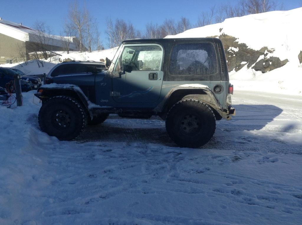

just cause you have done it dosent make it the proper way..
i ran 35's on a my last tj with 3 inch lift .. with stock gear stock D35 STOCK 4 banger 5 speed.. it was fine.. drove fine highway wasnt an option tho.. but regardless dosent make it right way to do it, just it *worked*
in the end it got 4:88's chromoly shafts and 33's but it was still a 4 banger and then frame let out i stripped ti kept axles for when i do my current jeep later this year, since they are already geared and i got another 4 banger ... lol
X2 on the Zone lift, in the end you probably still have if not more clearance unless you do a DC Shaft and SYE rather then TCASE drop for the 4 inch suspension lift ..
then regearing, unless all you do is crawl the malls, highway aint gonna be to fun.
many things to consider, but also need to consider its primary function..
and pics or it never happened comments lol : here it is:
