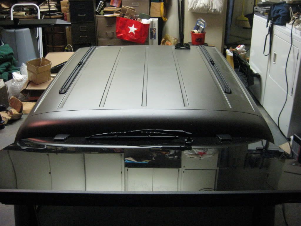

Junkyard Roof Rack. Cost me $50 for the rack and about 5 for the hardware.
i love my roof rack. The one from the Exporers can be broken down so I only have the rails during the summer. 10 minutes to add the crossbars to go snowboarding. I haven't put anything else on there because it's too tall to reach easily. I also don't know how much weight to put on it. I've had 3 snowboards and 1 pair of skis up there and it was fine.

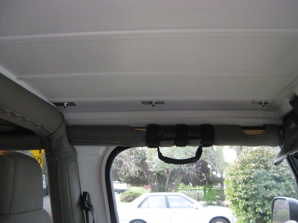

Here's another from a JY. Unlike Unlimited04's which is from an Explorer I believe, mine is from an older XJ. $25 for the rails and crossbars from the JY, and just a few bucks for the hardware. It took all of half an hour to install.
By the way, I had to trim mine down a few inches length and width wise to get it to fit better on my LJ. With my Yakima rack on there I have no issues carrying 1-4 snowboards to the mountains, 2+ hours away.

when you mount your roof rake from the pick & pull for $20. use fender washers on the inside for more strength. and put a little bit of gasket sealer/rtv silicone to keep the moisture out. No problems.
I got my roof rack off a ford explorursure. or one of the small fords, $20 is the going price. and I used two ATV racks from harbor freight to make the rack for the top.
So $120 or so I was in business with a rack on top my hard top strong enough for me to stand on at 200 lbs.
