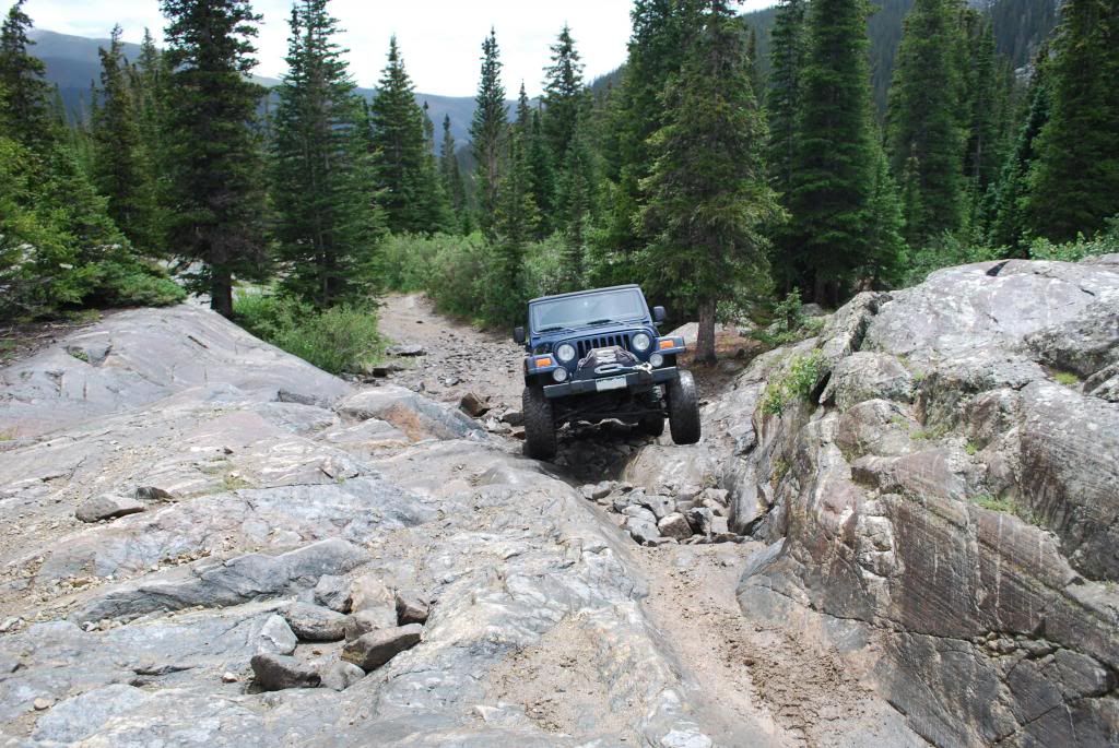

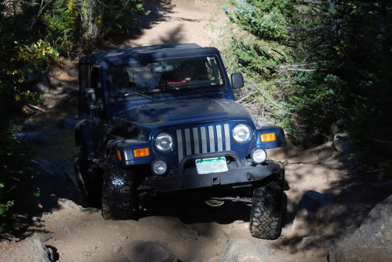

My TT's work well off-road so far...got me through here...

Yep it would in those pictures where all four tires are on the ground.

not everybody wheels in the desert over big boulders with tires off the ground, so they do work well off-road on a dual purpose rig in many cases
btw, two of those pictures show the rig in motion, with one tire catching air at times

Wheeler Lake, I love that trail. One of my favorites in CO for sure. I would say on the Flopper obstacle there that you can easily get one of the two wheels off the ground on your front and rear axles. I currently have a TT in the front and an ARB in the rear. Eventually I will go to a ARB in the front as well, but the TT has served me well and most people ask me if I have a locker when running up challenging sections on trails and until recently with the ARB locker addition the answer was always no. Unless you are doing a ton of rock crawling where tires are off of the ground then the TT is a great option and is very simplistic compared to a locker. I have found mine to behave wheel in the snow as well so it is definately better than a lunch box locker for those of us that see snow on a common basis.
