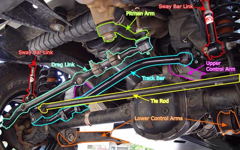

Worn out and cupped tires will aggravate death wobble, but aren't usually the root cause of it. Tires that are cupped will put more pressure on the steering components and cause whatever component(s) that is/are bad to reveal themselves. Replacing the tires will certainly help for sure, but once those get worn or you hit a large bump, the death wobble will return.
You need to physically check each component, sometimes by putting pressure on it with a pry bar in order to look for any loose joints.
-tie rod ends
-ball joints
-lower control arm bushings
-steering box
I know you stated you replaced the trackbar, but make sure the hole where it mounts on the axle is not wallowed out. That can cause issues as well and was the problem I had on my XJ. Pulling on the joints with your hands won't always reveal a problem unless they are REALLY bad, since cupped tires and potholes will provide more pressure than you can replicate.
Makes no difference if the bolts are properly torqued. Have you seen the lower front control arm mounts with cam bolts?
Agreed. But the bolt is usually not tight enough in the case of the trackbar hole being wallowed out.
