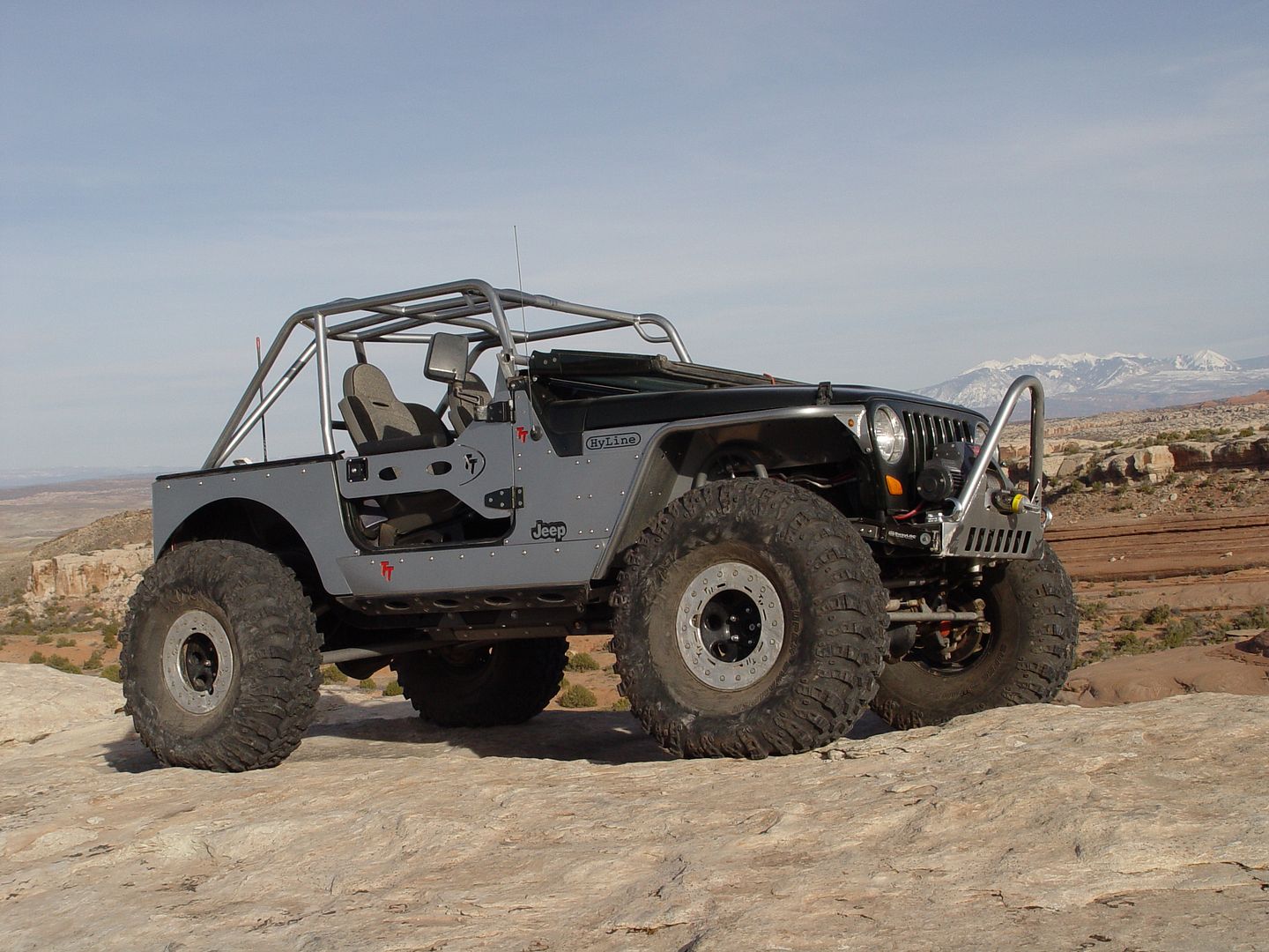

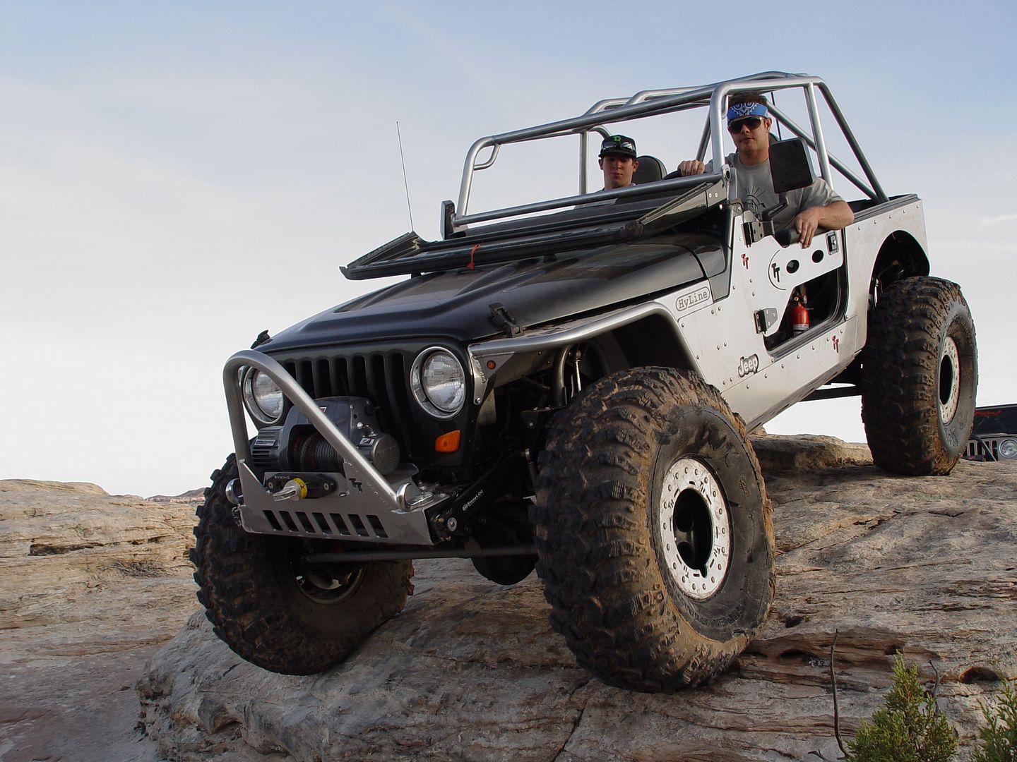

I know many of you have seen the Lo Rider on various forums, websites and even in a few magazines in it's current from.....
Welllllll, it's time to give da Low Rider some beef, bye bye D44's and some more wheelbase. We're shooting for 103". Prior to surgery, da Low Rider had an 99" WB, the front is already stretched 3" so you do the math were the other 4" is going to get added...
Stay tuned as we develop some new ultra cool parts to facilitate this type of TJ build. Let's just say we have a sawzall and am not skeert to use it. Other parts include,
1) Currie Rock Jock 60F, 5.13's, ARB, RCV shafts, Spidertraxs hubs and brake components 5 on 5.5, 64" wms2wms
2) Currie Rock Jock 60R, 5.13's, ARB, 40spline shafts JK brakes 5 on 5.5, 64" wms2wms
3) Maxxis Sticky Creepy's phodee " variety, on Trail Ready HD17's
4) GR 20g Fuel Cell
5) PSC Full Hydraulic Steering
6) Several boxes from King
Look for nice clean lines, well made parts and top notch install all rolled into one bad azzed TJ that works.

5.13 for the axles seems a little tall for 40s.
Any reason you're not going deeper to 5.38 or 5.86?

Between the manual transmission and the Atlas it'll do fine on the trail. For a little added power we're planning to install a late model H.O. intake as well although the 4.0 thats in it already seems alot peppier than others we've driven.

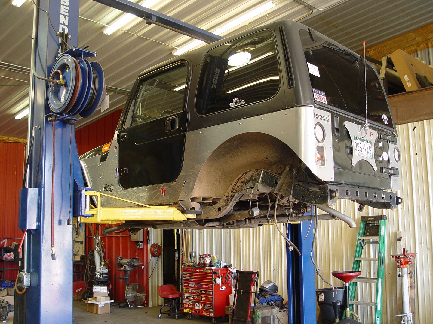

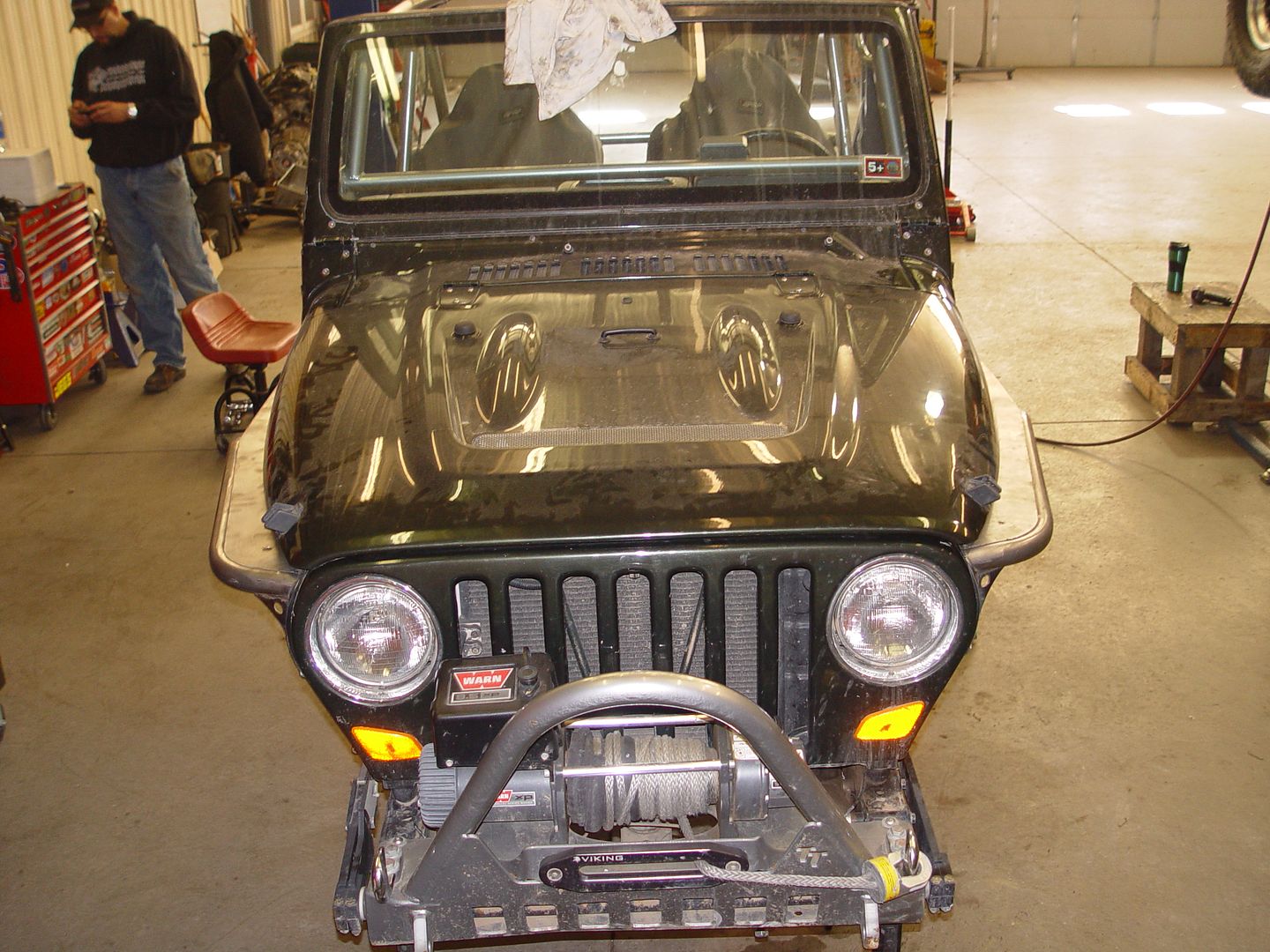

Out with the old axles

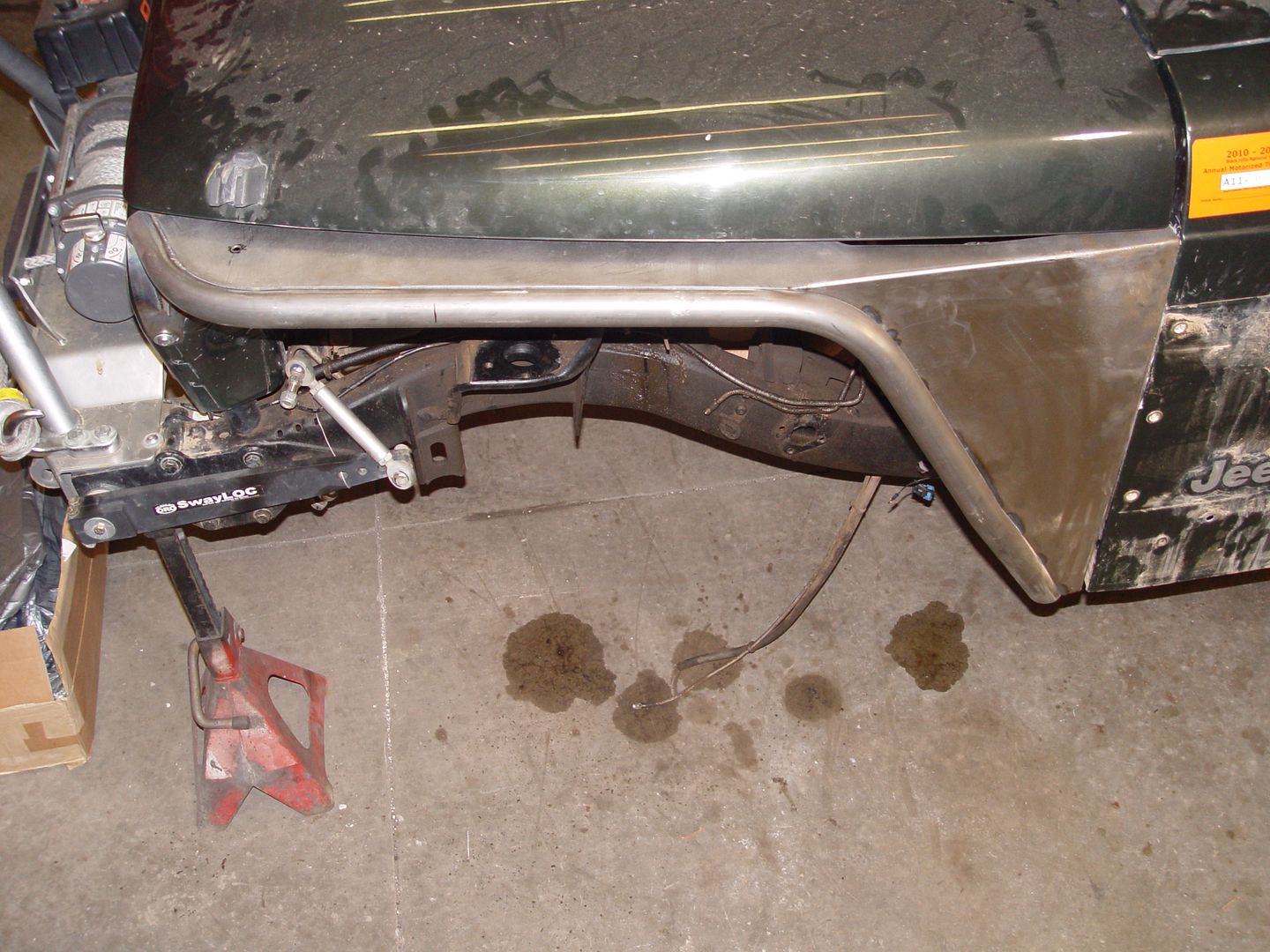

The "Lo Rider" was sporting some prototype aluminum HyLine Zyros fenders in the front which held up alright but with the abuse this thing is headed for some steel HyLine Phantoms will be better.
