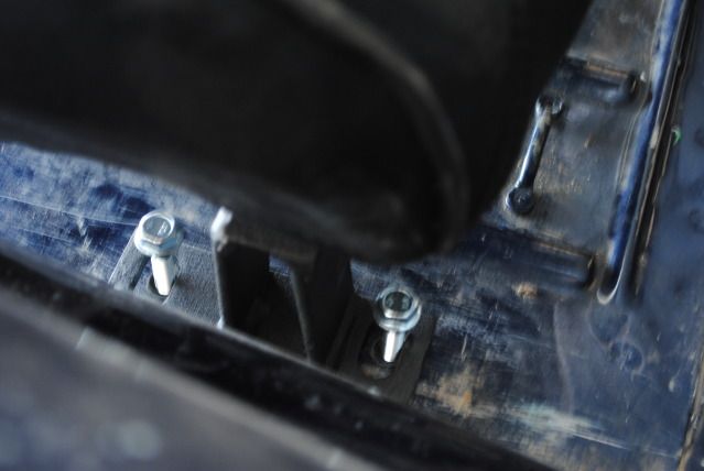

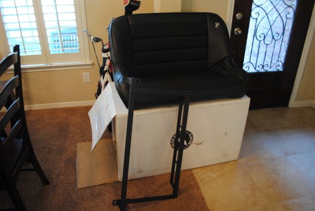

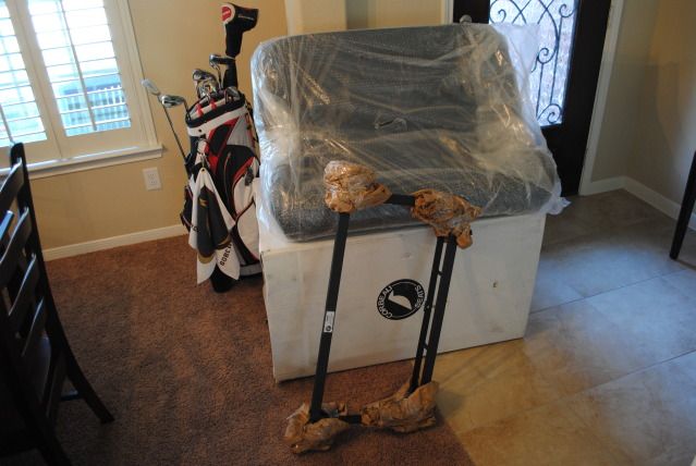

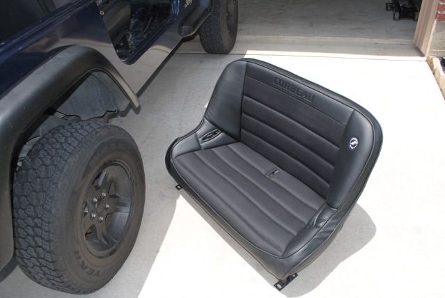

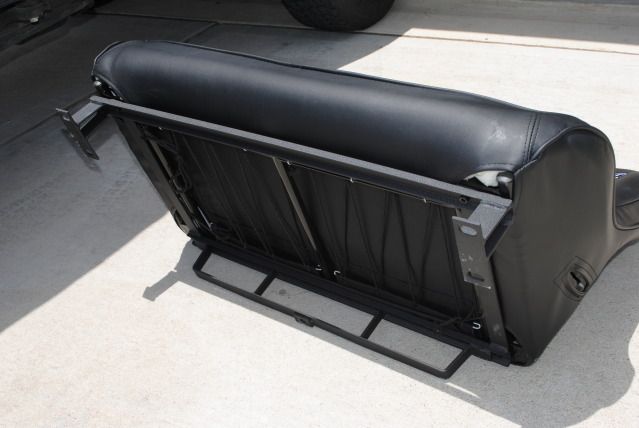

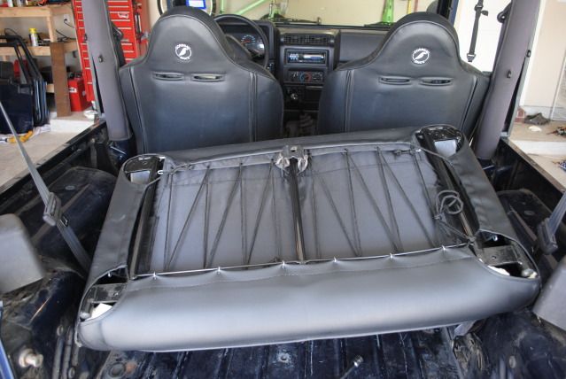

Originally Posted by Andybellus View Post
Anyone have tips or pics of the rear seat install?
Here are some pics from the install of the rear bench.
You have to unbolt the seatbelt from the lower tub to slide it through the hole in the sides of the seat and then rebolt before bolting the seat in place.
I bought new bolts to install the seat....flange head style 8.8 bolts. I tried the factory torx for the female buckles, but could not get a torx socket in there, so ended up replacing with a grade8 hex bolt.
You also need to pass the female buckles through the seat before installing the seat bracket. Then the buckles and seat bracket get bolted to the tub together.
The seat is awesome. My son loves it. If you have a booster or car seat, it will end up kinda pushed toward the center of the seat because of the side bolsters. That makes putting another person back there a challenge....for comfort anyway. Without baby seats, two kids fit perfectly.
